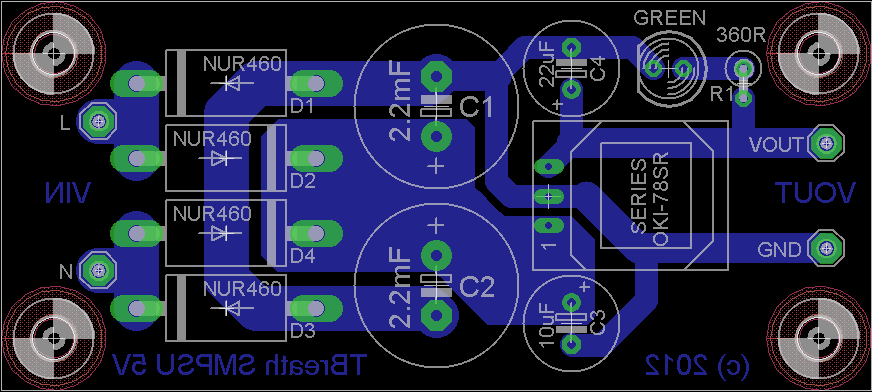

SMPSU5V
Here's a switcher board. This is gonna be my prototype, but I haven't got all the parts yet. Anyway - the board has place for enough smoothing caps to acommodate pretty high current draw. Rectifier bridge has place for pretty big diodes. The vreg comes in 5 and 3.3 volt versions, and is pin compatible with 78xx vregs. So 1 or 2 smoothingcaps / diodes / vreg can be adjusted to specific needs. I hope it works, because what attracts me to this is the high input voltage range. No need for mor than 1 transformer even if you are making a 5 and 15v power supply. This is part of my "modular" supply.
