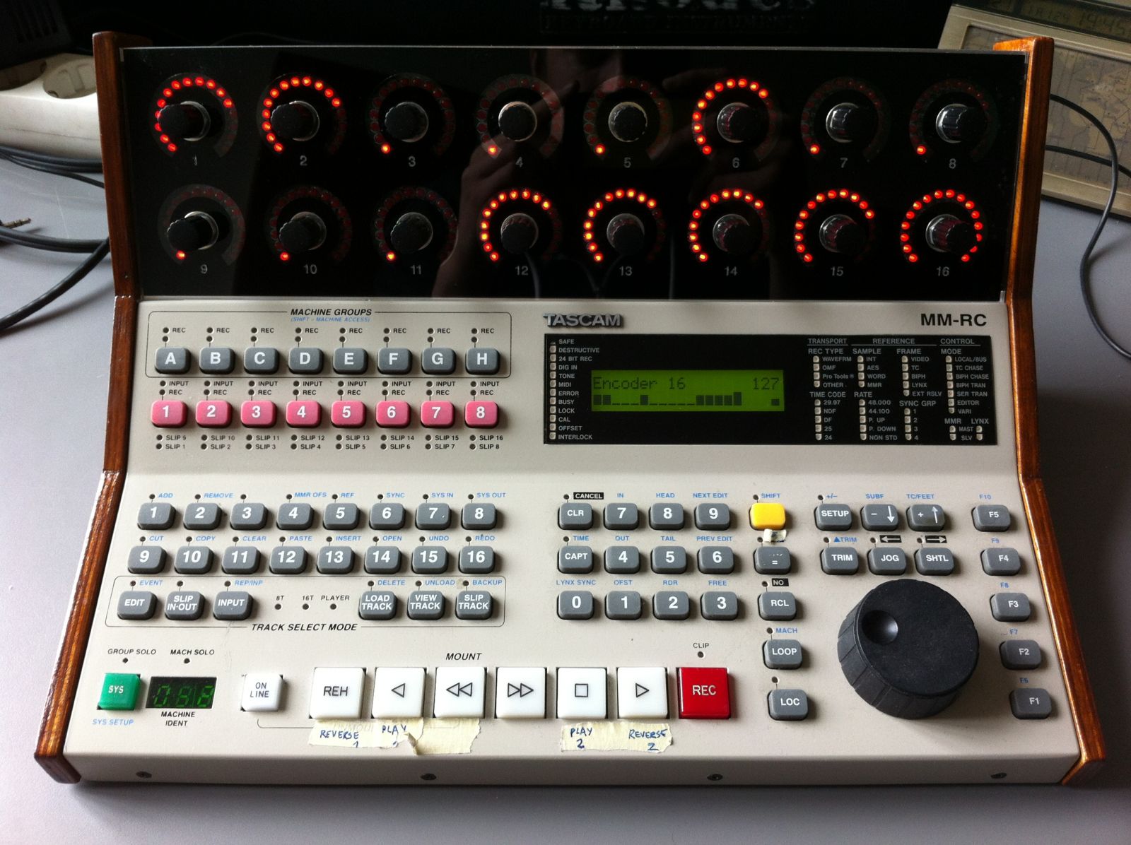

A Tascam remote control converted to a Midi controller. I kept the original control surface pcbs with all the small buttons and leds, but etched a new main board for the big buttons, 7-seg display and put a PSU + DINX4 + DOUTX4 on it. It was formerly based on a Core8, but I updated this to LPC17 and MB_NG.
So all in all it has
9x big buttons with leds
66x small buttons
137x small leds (driven by three MAX7221)
LRE 8x2 extension (16x encoder + led-rings)
hi-res jog wheel
3 digit display
2x20 LCD
Thanks to TK it's all working with MB_NG, I can even use this as a logic control.

Can you explain how you made the front panel for the 8x2 RLE please ? I really love the translucide effect on it.
Ender
rvlt
Posted
It's a 3mm clear acryl faceplate made by formulor (german ponoko) with 16 holes for the encoders and engraved numbers. Was around 20,- euros.
I put black self-adhesive foil *at the backside* on it, with cut-outs for the encoders and the led rings.
If you want I can send you the illustrator-files for both.

Yes please those files are welcome.
I have finally found a front panel really cool and affordable :) Thank you !
