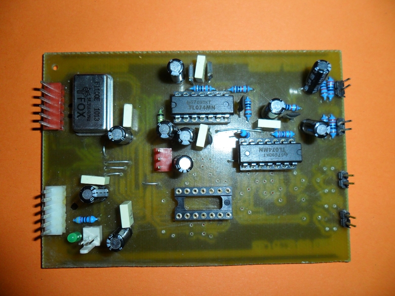

my core module pics check if you see somthing wrong Uploaded with ImageShack.us thx

1) Remove the LCD for testing (as it shares pins with the OPL3) tested the same 2) Check for shorts on the core>opl3 connection checked no shorts and tested with other core module the same !!! 3) Recheck the wiring (http://ucapps.de/mbh...connections.pdf) checked and rechecked no error 4) Shorten the cable between core and opl module not tested thats possible is only the cable in fault ? other test try other pic the first is a 18f457 try on 18f4685 the same tested with no eeprom on core board the same tested only the core the same error on d0 d1 d2 d3 thx
i retested the interconnetion test i have not tested if the other pin is to 0v is the problem ! check this tab with the votages Uploaded with ImageShack.us
get this from ic3 pin 10 Uploaded with ImageShack.us and this on ic3 pin 14 Uploaded with ImageShack.us thx all module Uploaded with ImageShack.us
i get this waveform on opl pin 21 and 22 which value for the resistor on headphone ? Uploaded with ImageShack.us
i use an ersa 3cs/331 30w and 1.5mm tips the chip are not burned i desolded it very carefully it does not have to heat only tepid check my new pic with light back the board thx for your help

i re tested the continuity and no bridge in smd chip ...
Uploaded with ImageShack.us Uploaded with ImageShack.us yep +15v and -15v 2x1.6amp 50va (my tr808 clone psu) Uploaded with ImageShack.us thx for your help best regards
hi all for 1 yac i need to solder other components ? original link Uploaded with ImageShack.us tested the module and no sound tested with mbfm_interconnection_test_v2 the connection its ok tested with mbfm_testtone_v1c no sound in out 1 or 2 i got a popping noise sound when turn on the mbfm ? best regards
