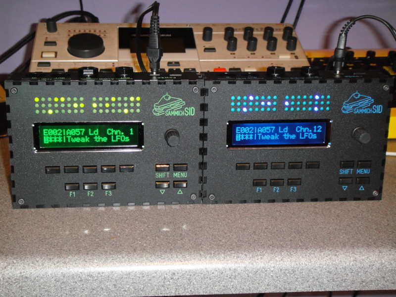

  1. :whistle: errr well...... i got a local engraver to fill them. I was having a rear panel made for my 9090 project build so i got them done at the same time. For what its worth, he struggled a bit as there is no depth to the engraving (laser etching?). I'll certainly ask the question as to what paint he used though. I know his approach was to remove the mask before filling though - but i guess he knew what he was doing... Here are a couple of better images... https://files.me.com/mwabrown/4puf7k https://files.me.com/mwabrown/1sqssh One point on the crystalfontz displays i used is that the LCD surround was plain metal - i had to "paint" it using a black permanent marker, otherwise it was looking a bit odd. Using the extended header was a breeze - the LCD is spaced off the board by 1 x m3 nut and washer - this brings it up to almost exactly the back of the front panel. Matthew
  2. Finally found time to finish No2 and raise the LCD of No1 (blue) - thanks go to Wilba for the extended headers!!! :thumbsup: Matthew
