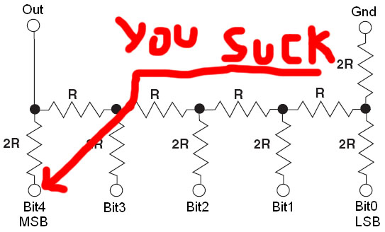

TK. Posted March 23, 2010 Report Share Posted March 23, 2010 This is a very interesting page: http://www.bel.fi/~alankila/c64-sw/index-cpp.html (btw.: wouldn't it be nice to use the improved filter models for the MBSID V3 VST/AU emulation? :) It gave me the keyword R-2R ladder DAC. As you can read in Wikipedia: Accuracy of resistor ladders Resistors used with the more significant bits must be proportionally more accurate than those used with the lower significant bits; for example, in the R-2R network shown above, inaccuracies in the Bit4 MSB resistors must be insignificant compared to R/32 (i.e., much better than 3%). Further, to avoid problems at the 10000 to 01111 transition, the sum of the inaccuracies in the lower bits must be significantly less than R/32. The required accuracy doubles with each additional bit—for 8 bits, the accuracy required will be better than 1/256 (0.4%). Within integrated circuits, high accuracy R-2R networks may be printed directly onto a single substrate using thin-film technology, ensuring the resistors share similar electrical characteristics Even so, they must often be laser trimmed to achieve the required precision. I don't think that the Rs were laser-trimmed in those years ;) So, how to solve this: I could add a fast accessible calibration table so that the "bad steps" can be excluded or smoothed out. It would consume 4k (not sure if so much is still available), but everybody would have to adapt it manually for his SID by editing the table and rebuilding the application. Best Regards, Thorsten. Quote Link to comment Share on other sites More sharing options...
jbartee Posted March 23, 2010 Author Report Share Posted March 23, 2010 (edited) Good work! 1980's tolerances strike again. The wikipedia article is super informative. I think the calibration table is a great idea... at least for me it would be no problem at all to edit and rebuild, and it would be great to kill those bad steps for good. I'd much rather do it this way then try to track down 6581's without the screwed up r-2r dacs, or worse yet "upgrade" to the 8580's (which are not my bag at all). Edit: ouch, 4k. Here's hoping there's enough available space! Edited March 24, 2010 by jbartee Quote Link to comment Share on other sites More sharing options...
