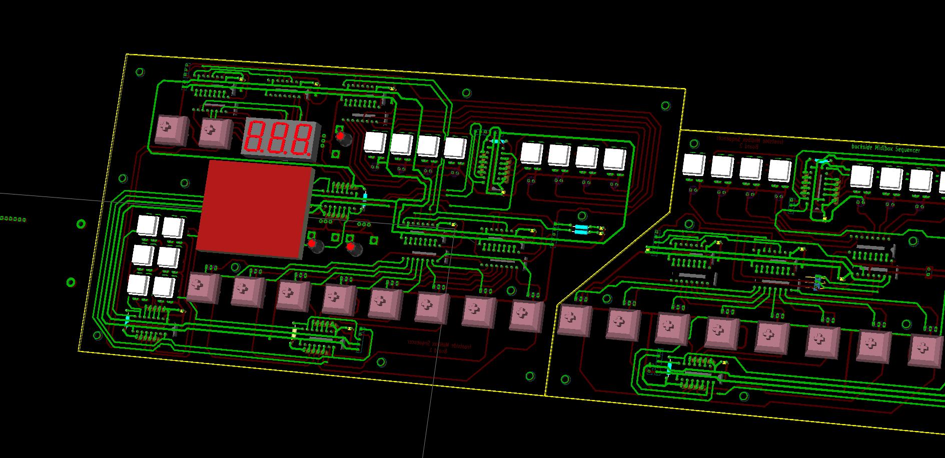

pcbatterij Posted October 20, 2011 Posted October 20, 2011 (edited) hey all, Just wanted to share a 3d pic of my MB9090 SeqV4 (Roland 909 clone). :sorcerer: And I would like to thank all of you that have already helped me: thanks :thumbsup: . A few things are not a 100% correct in this 3D pic: 1. The display is not the correct one, it will be a ea dogm display. 2. I don't have a 3d component yet for the BMP display 3. The colour of the switches is wrong, this will be clear/red with a red LED light to illuminate the buttons. 4. I don't have 3D components for the (PEC11) encoders, I just put some knobs in the pic. I almost finished designing the PCB's, and once I have done that I will post the schematics here and on my blog. http://www.bloggen.be/mb9090/ Once I know that the PCB is working, than I'll have to change a few things in the SeqV4 and MIOS32 software: 1. For a the dogm LCD I'll have to change the SEQ_LCD_PrintString commands, mostly in the SEQ_UI...... files. Hopefully with this display (8X21 characters with small font) I'll be able to modify most of the menupages with adding SEQ_LCD_CursorSet(0, 2); SEQ_LCD_PrintString........... SEQ_LCD_CursorSet(0, 3); SEQ_LCD_PrintString......... SEQ_LCD_CursorSet(0, 4); SEQ_LCD_PrintString.... ....... 2. I'll have to add some code to make sure that the encoder next-to the BMP 3X 7segment will always change the BMP, no matter what menu the sequencer is in. 3. I am not using 16 encoders so I will have to change and add code for one encoder to move "left" and "right" to the different fields that can be changed in the current view or menupage on the display. And for the other encoder to be able to change the value of the selected field. Could someone also help me out with the questions below: MB9090 board1.jpg: IA: Is this the correct order to connect the encoders with the 74hc165 (see also the INPUT schematics)? MB9090 board2.jpg: IIA: Is it ok to interconnect Ground and power of the DIN and DOUT circuit like I did? IIB: same question as IIA IIC: this is a KiCAD question: I don't know how I can put in the schematic or the board that these are connected through the connectors and wires. I have put a different type of labels in the input schematic than the ones in the output schematic but the result is the same :sad: That's it for now folks :D Cheers JefMB9090 input v1.21.pdfMB9090 output v1.21.pdf Edited October 28, 2011 by pcbatterij
Hawkeye Posted October 21, 2011 Posted October 21, 2011 (edited) Hi - nice pic! regarding 2), Thorsten has just added support for a direct BPM-changing encoder in RC .51 :-) regarding 3) - the left/right keys move you to the left and right - you can then use the standard encoder to change the note. Good luck hacking the displays, it can be fun and rewarding at times and at other times grey-hair accelerating :) Greets! Peter Edited October 21, 2011 by Hawkeye
pcbatterij Posted October 21, 2011 Author Posted October 21, 2011 Hawkeye, Thx. And thank you Thorsten for the .51 version with a dedicated encoder for BPM change!!!!!!!! cheers jef
