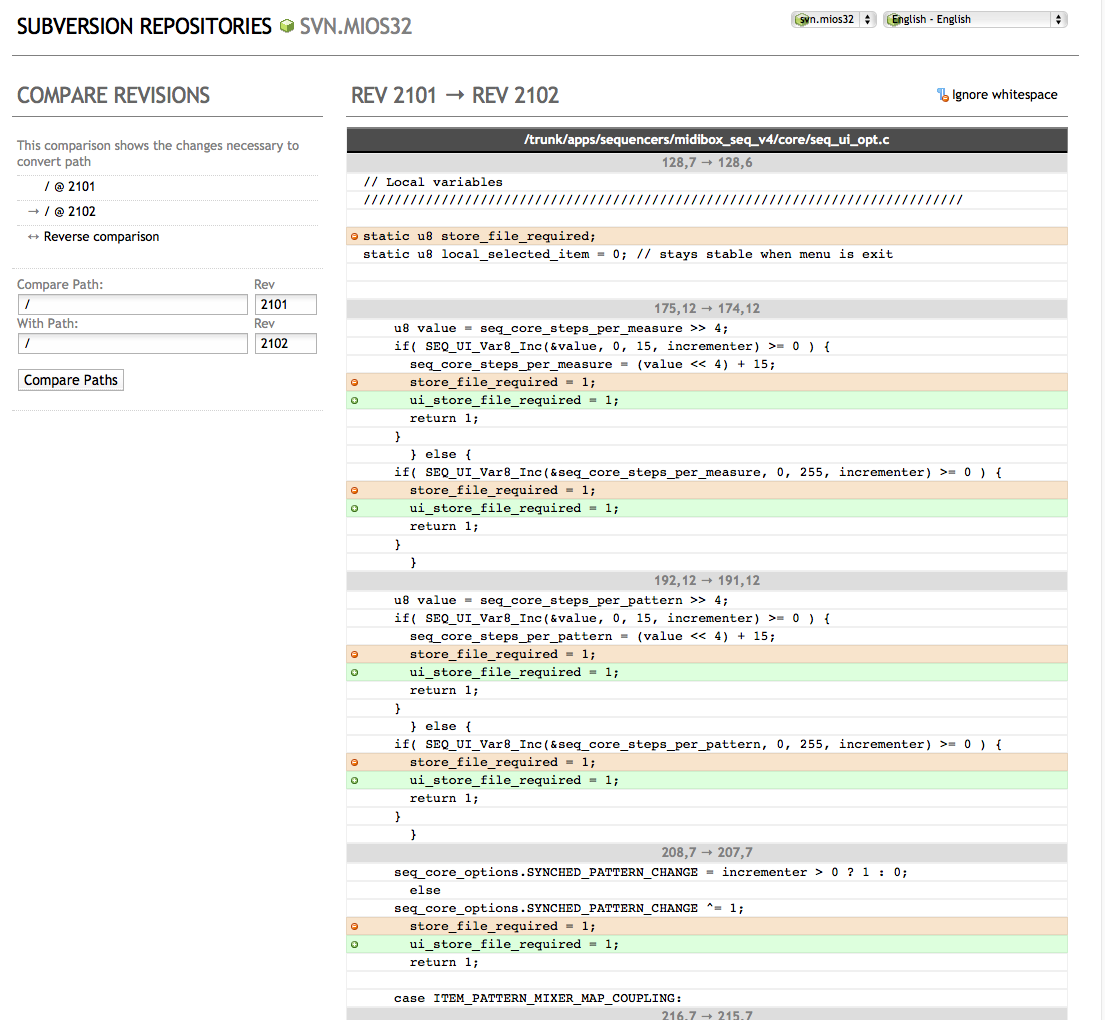

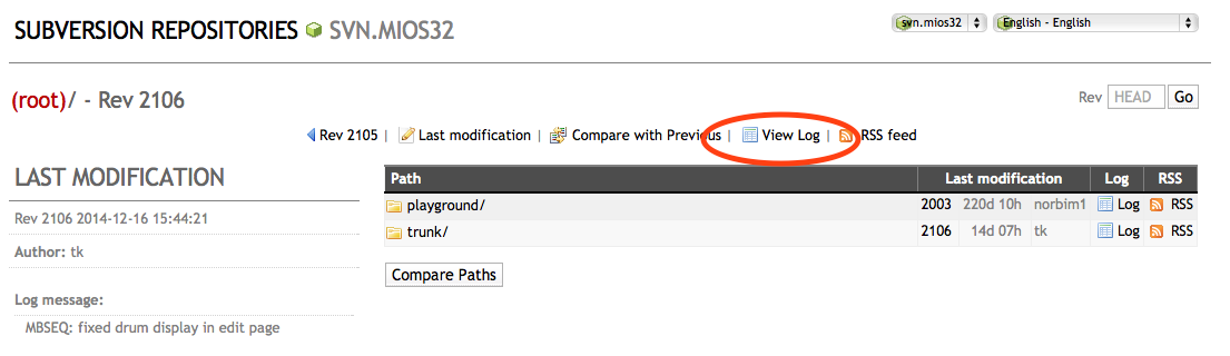

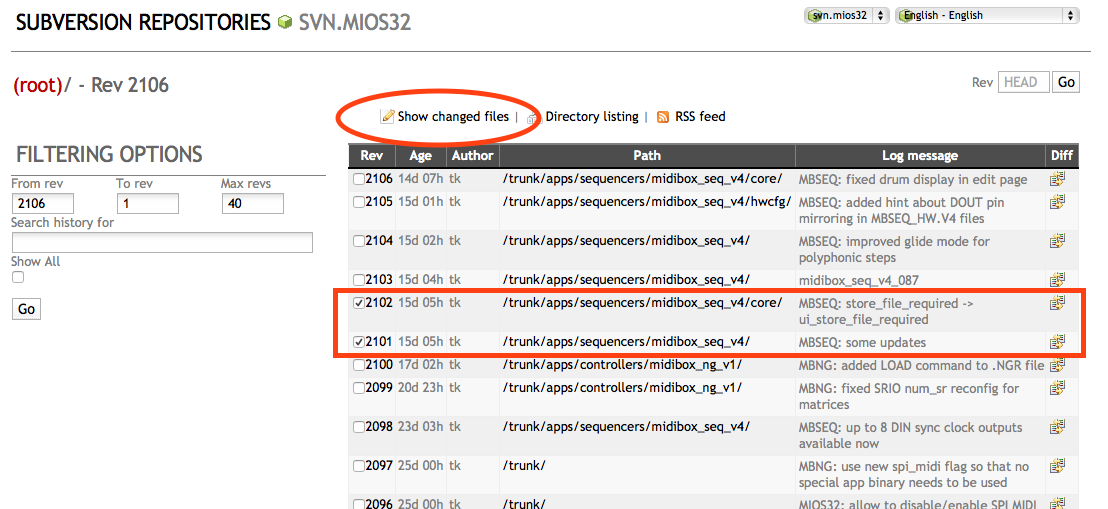

TK. Posted December 30, 2014 Posted December 30, 2014 Here a hint how you can retrieve the changes from an "official place" in order to get an impression about possible reasons for such issues. Go to http://svnmios.midibox.org Select the MIOS32 repository, and then click on the "View logs" button. Check the comments, they are sometimes helpful. Select the potential problematic version with a "known good" one, or whatever you want to compare. Then click on the "show changed files" button: This gives you a nice looking diff over all changes: And with some luck you will find out quickly, that the variable has been declared in seq_ui.c :) I'm using this web based method as well whenever somebody reports a problem after firmware changes in order to find out what I did ;-) Best Regards, Thorsten.
