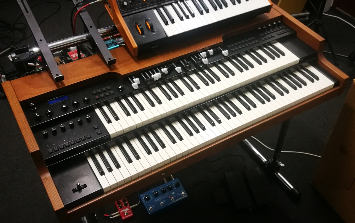

macsaif Posted October 19, 2018 Author Posted October 19, 2018 The controller is ready, only few small issues needs to be solved, however I can live with them. The velocity map and the midi channel switching is solved by Receivers and Senders, I am activating only the relevant receiver and sender: EVENT_RECEIVER id=4000 hw_id=4000 fwd_id=SENDER:4000 type=NoteOn chn=1 key=any range=map1 ports=0000010000000000 EVENT_RECEIVER id=4001 hw_id=4001 fwd_id=SENDER:4000 type=NoteOn chn=1 key=any range=map2 ports=0000010000000000 EVENT_RECEIVER id=4002 hw_id=4002 fwd_id=SENDER:4000 type=NoteOn chn=1 key=any range=map3 ports=0000010000000000 EVENT_RECEIVER id=4003 hw_id=4003 fwd_id=SENDER:4000 type=NoteOn chn=1 key=any range=map4 ports=0000010000000000 EVENT_SENDER id=4000 hw_id=4000 type=NoteOn chn=1 key=any range=0:127 no_dump=1 ports=1000010000000000 EVENT_SENDER id=4001 hw_id=4000 type=NoteOn chn=4 key=any range=0:127 no_dump=1 ports=1000010000000000 As I have mentioned in another post I would need a Load Snapshot command which is not triggaring any LED, Button, etc. and I will be ready. The photo of the controller: Frank
