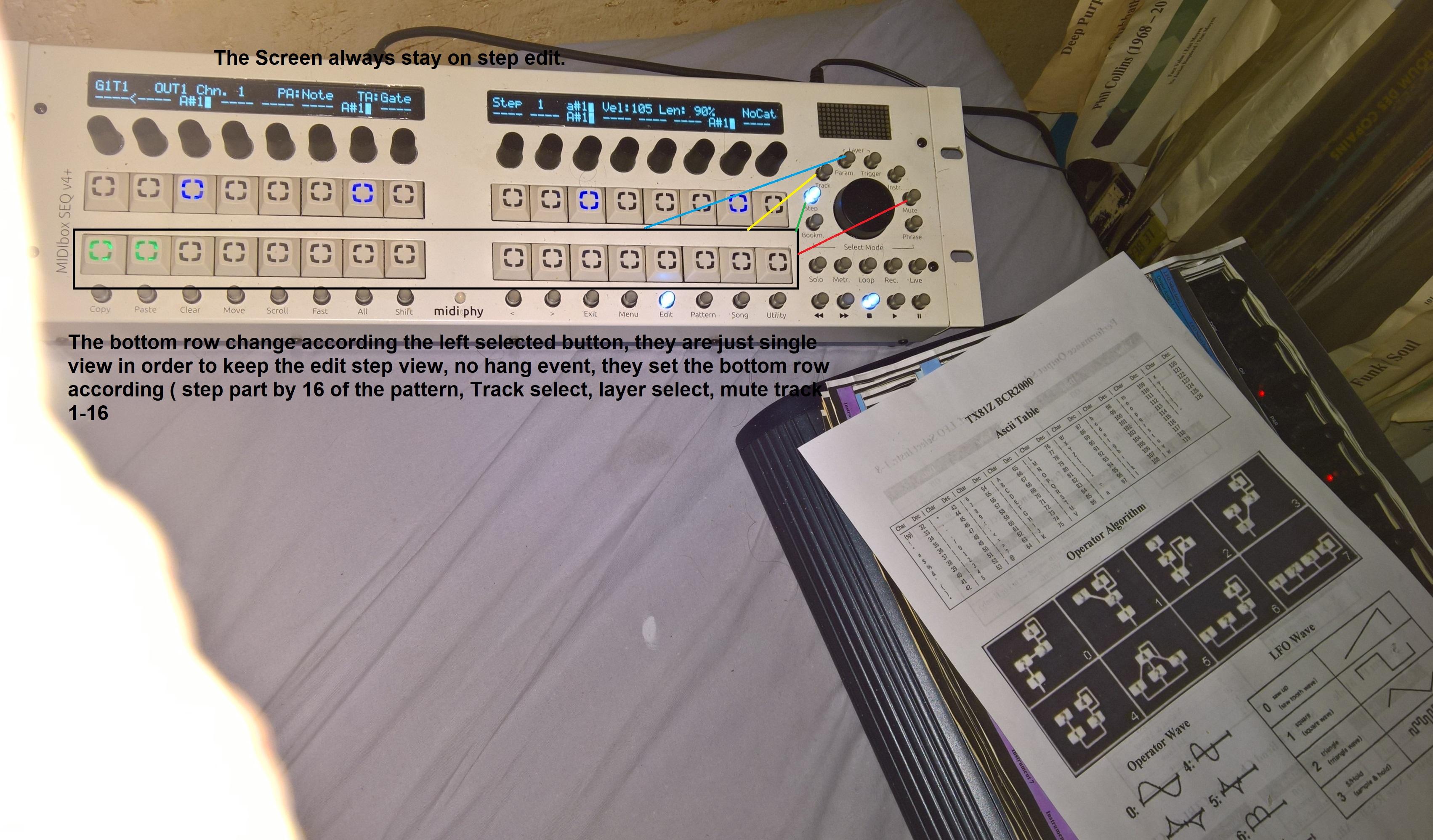

anonyme-x22 Posted March 14 Report Posted March 14 Hello, As i'm disabled, i mainly use the seq v4+ in lying position. However some of the most important around dial function need to be hold and a second hand is needed for selecting track. I was wondering if it would possible to add in the option a page where it would be possible to select if the button has hold or down mode. Furthermore the top would able to configure via this page the function of this button for hold, un hold or just down button. For example track button normal behavior when hold is select track by pushing the corresponding one, but after holding it goes to the step page which display note without any purpose, but you select the track by bottom row! Why note but the display confuse me with step edit so most of the time i think i'm on step edit where i'm in the unhold page of track. So for me the less confusing would be a down mode but with the hold page and no hold page. Same for params where the down page is less confusing than the hold one, so only down with down page would be required for this. I think i would be an excellent option upgrading the flexibility and disabled people more easy use. Thanks a lot, Have a good day, Rgds,

anonyme-x22 Posted March 31 Author Report Posted March 31 (edited) The issue with the toggle setup is that it does not resolve issue with not used page! For example, step button toggle, will switch between a graphical step view, and the step edit! Frankly the graphical view is useless for me, i don't any interest of seing graphically the steps, because bottom row show already where you are in the pattern by 16 step, plus the upper row the actual step reading! So actually it flash graphical view and after step view which is very annoying! So if use only toggle setting, it will be a mess, because i will have to toggle many time to select step! Furthermore, the thing has to be edited into a file etc, for that type of option, i think it isn't the right place! An option to say : For Step button two view mode On/Off, Two view mode type (toggle/hang), and Single page view type would make configuration a way more flexible and on the fly! Of course if two view mode off, two view mode type will not be effective, just the single page view type! It's the same thing with track, where the view choice is more arguable, but i think the most usable for me is the one switching bottom row from step part select to track select, then i just push back step to switch bottom row back to step part select! Same for param the one with note vue meter and so on, just annoying, so i would prefer it like this: Step button, i edit Param, i change the layer from bottom button etc.. Track button, i change the track from bottom button Step button, i edit all with just a push so each one would show only one view with no flashing or toggle of the not wanted one! An incredible speed up in pattern making, also a way more less flashing screen, and far less complex button management! Edited March 31 by anonyme-x22

TK. Posted April 3 Report Posted April 3 I guess that you are still in the thought process, but if I understand you correctly, it's sufficient to simply avoid that these buttons switch to their corresponding pages. Instead the 2nd GP row should just take over the selected function. Here a trial which can be extended based on feedback: http://www.ucapps.de/mios32/midibox_seq_v4_098_pre9.zip In your MBSEQ_HW.V4 file, add following setting at the bottom: ################################################## # Special Behaviour of some selection buttons of # the Antilog Frontpanel (to be documented...) # 0: default behaviour # 1: simplified behaviour ################################################## BUTTON_BEH_SIMPLIFIED_ANTILOG_FRONTPANEL 1 This will set seq_hwcfg_button_beh.simplified_antilog_frontpanel and I inserted a condition at some places, see: https://github.com/midibox/mios32/commit/279a0e391f858a06e3409c7783d104ad5b2d1cd2 Please let me know if this goes into right direction. Best Regards, Thorsten.
anonyme-x22 Posted April 5 Author Report Posted April 5 (edited) Hello, Many thanks, it comes in handy, i just left the machine because was to annoyed by the page flipping of all those button. It's just day and night for me, again many thanks just so more usable. Meanwhile i remixed the issue in my head several day, but perhaps the main problem is that there are page more adapted to pattern edit and some page that are more adapted to song playing, like graphical pattern display, or graphical track mute, graphical layer mute , graphical track select etc! So i thought that perhaps the best way will be that as soon as the edit button is lite, the workflow i mentioned before is applied, and when song mode is lite the graphical page are applied, this will remove forever those hang button behavior, and will make everything more consistent keeping all the page and bringing them as the best moment for their use. However in whatever your're in song mode or edit mode, bookmark and phrase button, should have always the same page, with no hang as shift can switch the phrase mode page, but most over song button is exactly the same behavior as phrase mode. I think that for those two button, the song mode should get to the menu (copy...phrase mode...takeover) whereas the phrase button should engage what is in fact the song configuration layout! "As the graphical page for step, track select, mute track make all senses, does the param/layer/ins one are really making sense?" However, I think is the most optimized workflow remaining everything in place while removing hang action on most of buttons! But if you absolutely think that the default behavior (hang) has any meaning/necessary for compatibility: In the simplified mode an option so when you lite song button the around dial button show their graphical page (hang one) instead of the the edit one, and the edit button will show the actual behavior. And why an option, because while it brings all the page back without hang, perhaps some won't need them! Rgds, Edited April 5 by anonyme-x22
