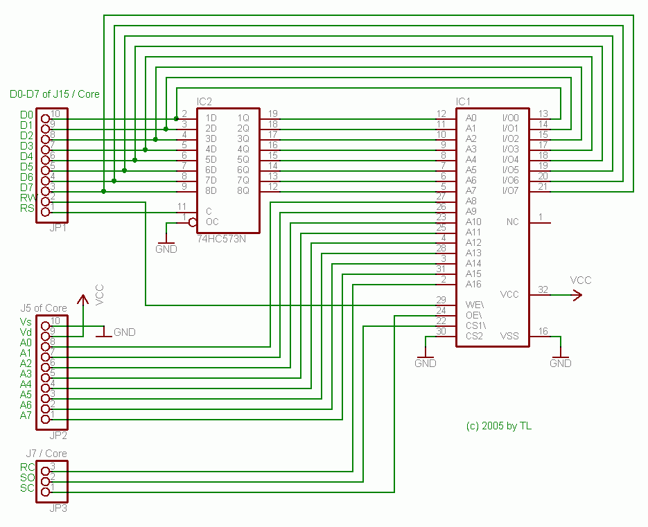

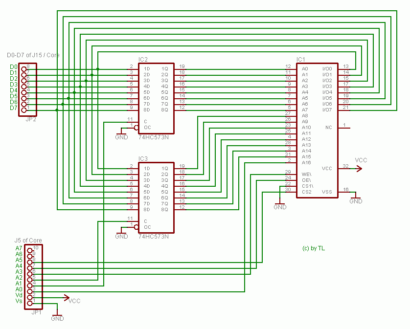

TL Posted March 14, 2005 Posted March 14, 2005 data lines could be connected in parallel to the LCD port, 8 address lines could be multiplexed with the data lines like known from 8051 designs (by using a 74HC573 latch)8 additional address lines could be connected to J5the remaining address line to J7:RCthe chip select to J7:SOthe latch enable to J15:RSthe R/W to J15:RWWouldn't it be easier (and maybe even faster) to use D0-D7 from the LCD for both the address and the data lines of the SRAM using 2 Latches for the address lines?Since it simplyfies the connection of the SRAM module to the core (only 8 Connections from RB0-RB7) and some pins of J5 for ALE of latches, the remaining address lines (A17), R/W, etc.And it would simplify the calculation of the address bits to output: take the low byte (D0-D7)of the SRAM address put it in the first latch, put the high byte (D8-D15) of the address to the second latch, set some pin of J5 to the value of A16 and read/write the data to/from the SRAM.If this would make sense, I could make a schematic the next few days...
TK. Posted March 14, 2005 Posted March 14, 2005 Hi TL,yes, this is also possible, but increases the latency from calling the data read/write routine and accessing the data bus. On such a complex sequencer project best performance is always desired.However, I guess that schematics for both solutions would be interesting for Todd :)Best Regards, Thorsten.

TL Posted March 16, 2005 Posted March 16, 2005 I've done a quick schematicDownloadIt's not tested so I don't know if it works... ;)

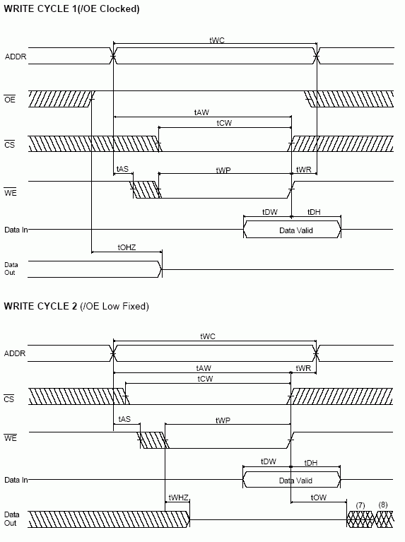

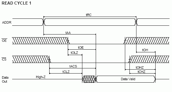

TL Posted March 17, 2005 Posted March 17, 2005 For the 128k x 8 SRAM 17 address lines, 8 data lines and 3 control lines are necessary, makes a total of 28 pins.And from the core schematic, RB0-RB7, RA0-RA5, RE0-RE2, RC0, RC1,RC4, RC5, RD5 and RD6 could be uses, makes 23 pins.So at least one latch must be used.Yes, these timings are explained in the datasheet.Here are the 2 diagrams for read and write access:Yes, a parallel A/D and SRAM could use most data/address lines together, but the A/D and the SRAM must use their own Enable lines...
TL Posted March 17, 2005 Posted March 17, 2005 And here is the schematic of Thorsten's idea:DownloadPlease keep in mind that both designs are a little bit simlified since the bypass caps are missing, which are important for the SRAM...And I'm not sure about the use of J7 / SC, maybe another pin of the core should be used instead... Thorsten ? ;)
stryd_one Posted March 18, 2005 Author Posted March 18, 2005 Awesome TL. This is more complex in a way, but as TK said, perhaps it will be faster. The more I look at the schematics, the more I can see that you have put quite a bit of thought into this and I want to say thanks once more.OK, so like... Not to try and pretend like I actually have a clue ;) , but I've looked at the datasheets for both, and RC0 (J7:RC) seems to be a compatible pin for the job, and I don't think it will clash with any other MIOS operations...Did I pass the test? :D

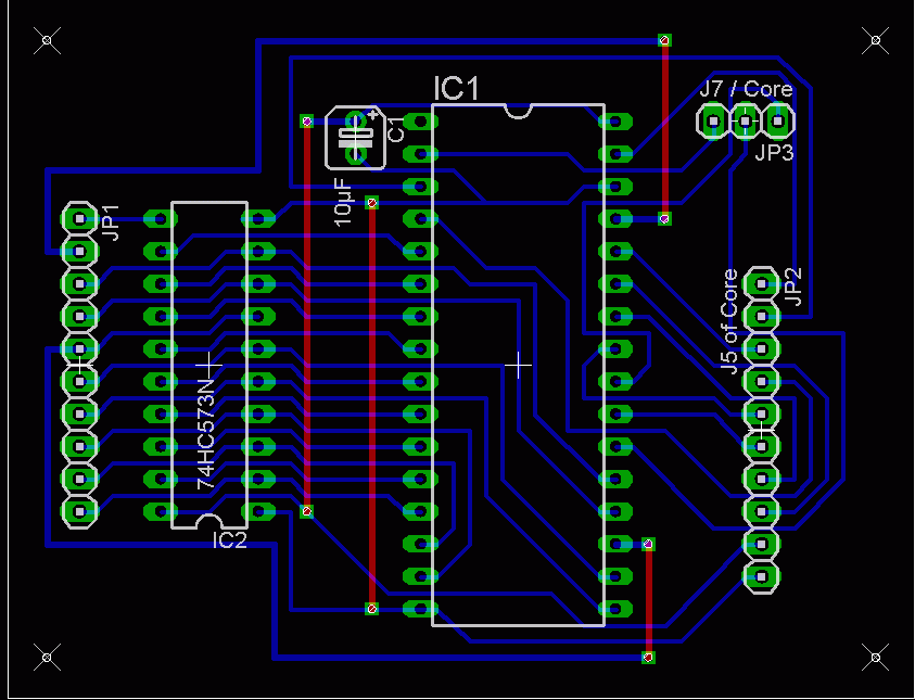

stryd_one Posted March 19, 2005 Author Posted March 19, 2005 OK, I give up... I've been trying to convert this thing to a board in eagle (I did my own schematic which is very much the same as the above)... Maybe it's meant to be difficult, but to make this a one-sided board, the best I've been able to do is to have 11 airwires! Is it likely to be this difficult? Or is it just cause I'm a newbie?Perhaps a double sided board would be more appropriate... But perhaps that makes it difficult to build, from a DIY point of view?Maybe I should stop asking so many questions and leave it to those who know what they're doing... But I don't want to make you guys do all the work unless you want to.... That said, I'm happy to do all the coding work once it's made, so...... What do you think?
banneduser Posted March 19, 2005 Posted March 19, 2005 OK, I give up... I've been trying to convert this thing to a board in eagle (I did my own schematic which is very much the same as the above)... Maybe it's meant to be difficult, but to make this a one-sided board, the best I've been able to do is to have 11 airwires! Is it likely to be this difficult? Or is it just cause I'm a newbie?No, you're doing just fine ;) Routing memory busses on one-sided board is just pain-in-the-You know where. Airwires on any "more complex" designs are unevitable.Perhaps a double sided board would be more appropriate... But perhaps that makes it difficult to build, from a DIY point of view?Double-sided boards ARE doable from a DIY point of view - it just takes more patience and skills.. alignment between two sides must match really well. But routing a double-sided board is just so much easier task.Maybe I should stop asking so many questions and leave it to those who know what they're doing... But I don't want to make you guys do all the work unless you want to.... That said, I'm happy to do all the coding work once it's made, so...... What do you think?Pheww-- any volunteers?Bye, Moebius

TL Posted March 19, 2005 Posted March 19, 2005 Here is my first pcb design.This is my very first pcb design, so I don't know if it would work in the real world...Any comments about this are welcome... :)
d2k Posted March 19, 2005 Posted March 19, 2005 Well, here's another layout...single sided, 2 bridges (+5V/GND lines):Had to change a few connex from TLs' original schemo in order to route without that many bridges...
stryd_one Posted March 19, 2005 Author Posted March 19, 2005 :o* Todd bows to his superiors * ;)You've even put in the bypass caps!Thanks guys! I think I better start coding!(long pause while thinking) Hangon a sec, did you just call me ekaf? ;D How'd you figure that out?! hhehehehehehe
