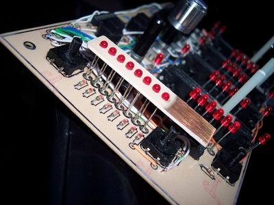

Posted
This is also only proper way of soldering LEDs To the right distance and X/Y position.
Yeah, I did a board a few months back with a buttload of 3mm's on it. >:( After I saw how far off they were looking, I went back and etched this thing to hold them while I soldered. I had to desolder a couple rows and start over with the guide.
BTW- It started off as a row of 3mm circles with a center hole the size of a small drill bit. After etching, the center hole acts as a drill guide to get the holes in the right spot, then I enlarged them with a 3mm bit. My big problem before was in keeping the heights even. The lights are a nice snug fit in the guide holes, so you can line them up and they stay there while you solder.
