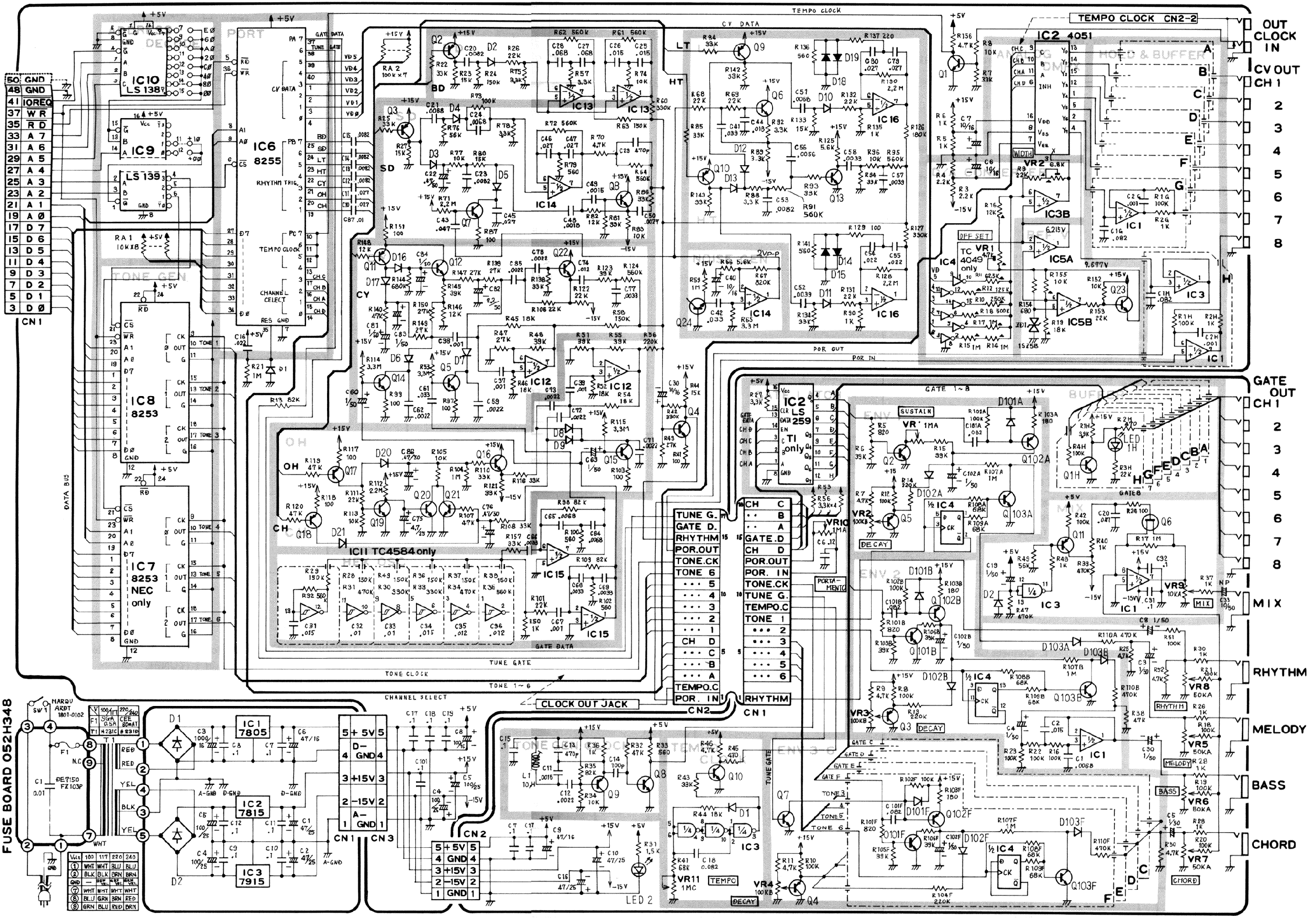

inteliko Posted December 7, 2007 Posted December 7, 2007 CMu-800r schematics and manual via Kevin Lightner of Synthfool and synthdiy.comhttp://www.synthdiy.com/show/file/?id=1526http://www.synthdiy.com/show/file/?id=97I'm gettin excited about this project....
nebula Posted December 7, 2007 Posted December 7, 2007 I listened to the demo on the Japanese guy's site and really liked the drum sounds. Very pleased to see that the schematics are posted here ... but of course it doesn't say what the op amps and transistors are.So, if anybody happens to be gandering around inside your CMU-800, please try to make a note of those semiconductors. I think CMU drums would be kind of exotic :)---Just had a chance to look at that pdf manual, too. Don't snicker too loudly when Roland proudly exclaims:There is no need to say welcome to the future. It is in your hands now.At first I chuckled, then when looking through the manual, I realized that this may well be the first mass-marketed, personal computer-based sequencer capable of synchronizing with other sequencers and drum machines, and controlling external pro synths. We're talking 1982 here! This is awesome!
