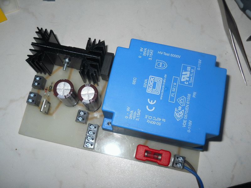

5Volt DC 3Amp - 9Volt AC 3Amp pover supply for MB6582

also nice to see the crowbar circuit :-)
Could you do an A-B listening test with your old C64 PSU, if you have one?
I seem to have slightly more noise with this PSU (like a 50Hz hum, but don´t know where it comes from- the components are all top-notch and the capacitators should work their ripple-softening magic...)
Greets, Peter

Peter,
I dont understand ; do you have noise with C64 PSU or with this new PSU?
Yes I have an old C64 PSU for comparison but I will be able to do the test when I will finish the MB6582.
Antonio

Hi Antonio,
I feel to have a little bit more noise with the new PSU... but not really very well audible, i´d be interested if you hear it, too - but no hurries... have fun building the rest of the MB6582 :-)

OK now is clear :)
It is strange as you used modern el-parts.
may the crowbar section insert some noise ?
This is the first time I use it in my linear supply ( usually I trust in 78xx ).
Greets
Antonio

Hi Antonio,
I am not good enough in electronics to guess what is exactly wrong... but I somewhere read, that ground-hum can be because of the ground connection between different audio gear, that have different PSUs.. gotta read more regarding this... and test, if the hum also occurs, if I only plug head-phones into the MB6582...
Other possibilities would be the crowbar, as you mentioned (could deactivate that subcircuit for a test)... or wrong filtering capacitators....
but I don´t have a oscilloscope to have a peek, yet :-)
But it is not really problematic, just barely audible, and am interested, if you hear it, too ;-)
Greets and have a good time!
Peter

3 Ampère ? and you use Vregs in TO-220 package !!
please please which Vreg are you using? i just know the 78Sxx / 79Sxx type that can deliver a max of 2A.
but i need moar :rolleyes:
