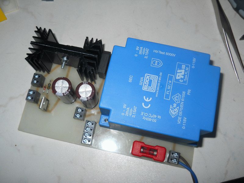

Hawkeye 58 Posted August 30, 2011 That looks good :-) If I only could remember where I´ve seen a PSU like this before :-)
Hawkeye 58 Posted August 30, 2011 also nice to see the crowbar circuit :-) Could you do an A-B listening test with your old C64 PSU, if you have one? I seem to have slightly more noise with this PSU (like a 50Hz hum, but don´t know where it comes from- the components are all top-notch and the capacitators should work their ripple-softening magic...) Greets, Peter
Antix 8 Posted August 30, 2011 Yes.... if you make me think about ...seems that I see something like here in the forum :whistle:
Antix 8 Posted August 30, 2011 Peter, I dont understand ; do you have noise with C64 PSU or with this new PSU? Yes I have an old C64 PSU for comparison but I will be able to do the test when I will finish the MB6582. Antonio
Hawkeye 58 Posted August 30, 2011 Hi Antonio, I feel to have a little bit more noise with the new PSU... but not really very well audible, i´d be interested if you hear it, too - but no hurries... have fun building the rest of the MB6582 :-) Greets, Peter
Antix 8 Posted August 30, 2011 OK now is clear :) It is strange as you used modern el-parts. may the crowbar section insert some noise ? This is the first time I use it in my linear supply ( usually I trust in 78xx ). Greets Antonio
Hawkeye 58 Posted August 31, 2011 Hi Antonio, I am not good enough in electronics to guess what is exactly wrong... but I somewhere read, that ground-hum can be because of the ground connection between different audio gear, that have different PSUs.. gotta read more regarding this... and test, if the hum also occurs, if I only plug head-phones into the MB6582... Other possibilities would be the crowbar, as you mentioned (could deactivate that subcircuit for a test)... or wrong filtering capacitators.... but I don´t have a oscilloscope to have a peek, yet :-) But it is not really problematic, just barely audible, and am interested, if you hear it, too ;-) Greets and have a good time! Peter
rosch 3 Posted September 6, 2011 3 Ampère ? and you use Vregs in TO-220 package !! please please which Vreg are you using? i just know the 78Sxx / 79Sxx type that can deliver a max of 2A. but i need moar :rolleyes:
Antix 8 Posted September 7, 2011 MC78C05T FTW! 3 Amp TO220 5V Voltage Regulator http://www.datasheetcatalog.org/datasheets/166/438769_DS.pdf
