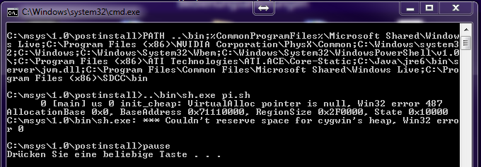

  16. I read a lot in this Forum and all the WIKI Pages, but it's not so easy for a newbie to find the way through the docs. I just built a MBHP_CORE_LPC17 module and a AINSER64 module and connected them to 8 Pots. I uploaded MIDIO128 V3 and with mios_studio I can see, the MIDI signals were transmitted and everything works fine. So the next step I want to make is to learn how to program my own app. I already programmed something in different languages but always had some step-by-step tutorials so that I had only to write code in the end. Now I'm trying to follow the instructions here http://www.midibox.org/dokuwiki/windows_toolchain_quickstart I'm on Windows 7 64-bit; Install of sdcc-2.8.0 works fine. When I want to install msys 1.0.11 the following error appears: So what can I do? And the next question is already here: Do I need the GPUtils, also of I don't have a PIC Microcontroller. Or am I follow the false wiki page? Should I follow this http://www.midibox.org/dokuwiki/doku.php?id=windows_mios32_toolchain_core&s Thanxs a lot for help
