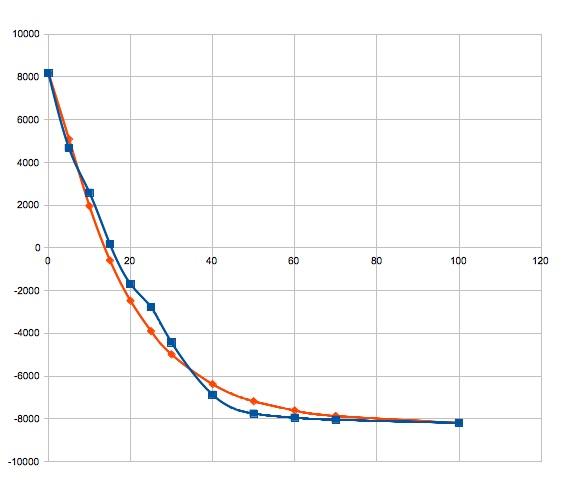

  8. hey here it is first graph: X is dB reduction Y is pitch bend value red is the value read in MIOS according to DAW position fader blue is the value read in MIOS when I position my fader at real analogue attenuation I want the 2 curves to be the same :smile: second graph: X DAW fader pitch bend value Y analogue fader pitch bend value each point take for the same attenuation in dB (0-5-10-15-20-25-30-40-50-60-70-inf) I want the line to be a straight one :smile: ----------------------- let take the example at 10dB attenuation (ref to full top position) DAW send a PB value of 1252, but at this value the motor driver don't put my analogue fader at 10dB attenuation, the fader need a PB value of 2576 to achieve this. So, I need to translate value 1252 to 2576 at 20dB I need to translate -2480 to -1696 etc... Zam
  9. hello Novski Off course I use the MF Tool !!! I don't know how i can explain thins in other way :( DAW fader log scale and analogue console log track are not the same log, and i need them to match. The -18dBfs is a studio reference, nothing to do here. The 0dB attenuation is always on the top of a resistor divider, but most of the manufacturer put a 0 ref label at -10dB attenuation and put a 10dB buffer after the fader so unity gain are not on top what I need is a solution to convert DAW fader pitchbend value to another physical fader position on the MF_NG side example: pitchbend value 0 set the fader half way, 50mm from top in a 100mm fader. But how can I do this 0 value put the fader 25mm from top? I go to make some measurement and tab and i'm back :smile: Zam
  10. mmm... I have some read in the manual did MAP command be a solution? I also see the "curve" setup in the CV tool, i think it's something like that I need, but with a custom curve, that i can adjust...
