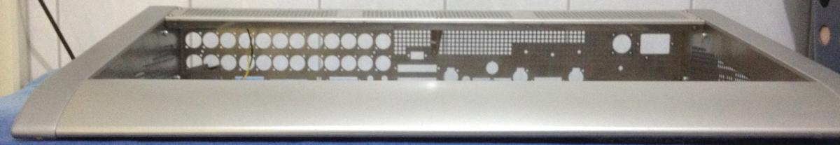

  1. Tidy up my workshop... :wacko: Mixer desk housing: Front panel area 73cm x 30cm Hand rest: Anodized Aluminum Housing: Inox Faders: 18 pcs. per set: Alps (CP K-Type Master, 10kOhm lin., Coreless Motor). Were used in prototype mixer 18 pcs. per set: P&G (PGFM3200, 10kOhm lin., Corteless Motor). Were rarely used in a prototype mixer but need cleaning from dust. Jog wheel: 50mm diameter, black plastic with rubber ring, for 6mm D-shape shaft --------------------------------------------------------------------------------------------------------------------------------------------------------- 1 set includes 1 desk housing, 1 Jogwheel, 18 motorfaders 4 sets to sell (2 x P&G and 2 x Alps) No shipping!!! - Has to be picked up in Switzerland (30km east of Zurich City) 1 set: € 50.- (payable on pick-up)
