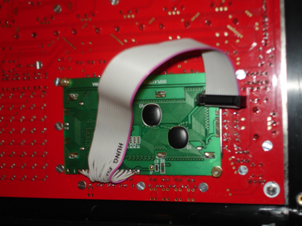

  5. I'm not very sure if i have correctly mounted lcb ribbon into connector, perhap i have made a mistake !! Please could you tell me if that's the right way in the photo Thanks !-]
  6. Ok thanks, i will try that now !

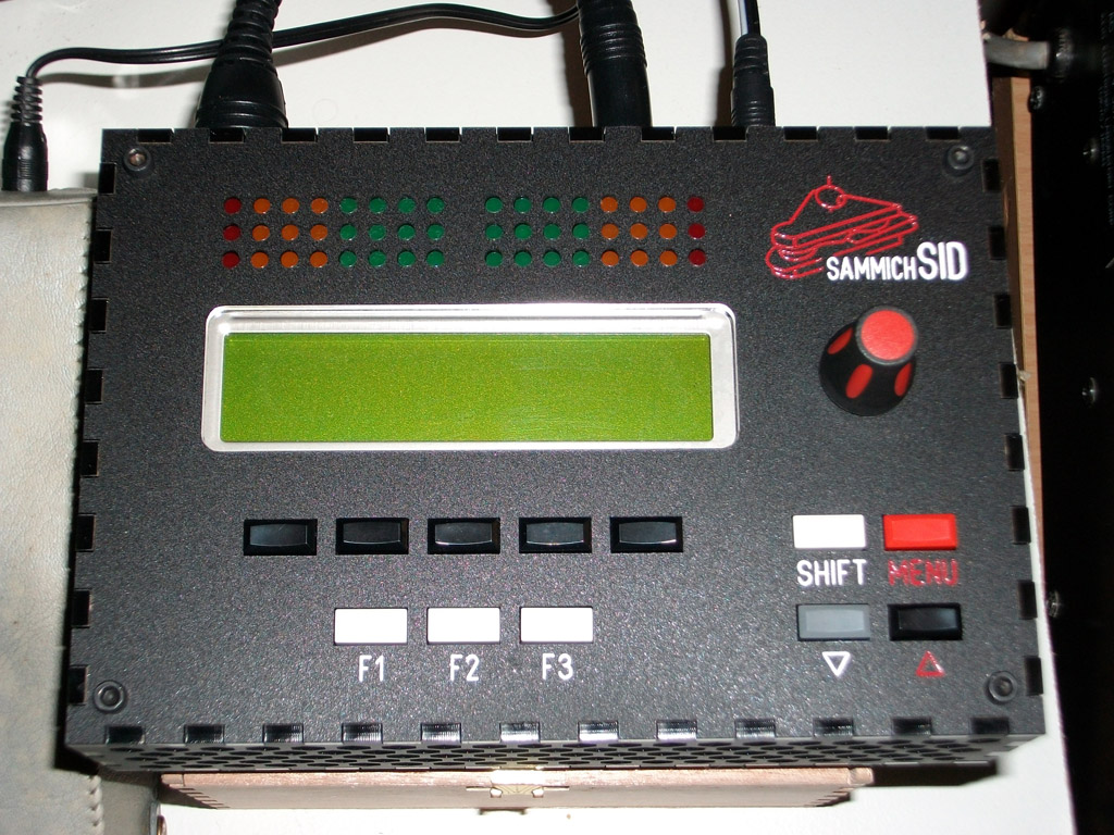

  8. Hello, Thanks Wilba for your nice comment ! i've used this paint, that's enamel paint ! I have bought it on a model shop and it's normaly used to paint car. When i was young i've already used this kind of paint for Role player game soldier or knight !! Thanks to midibox forum i keep my young spirit ;-) !!

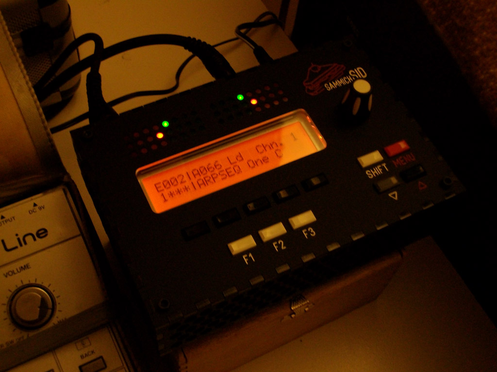

  9. So Happy with my sammich !! I love C64 sound :-)

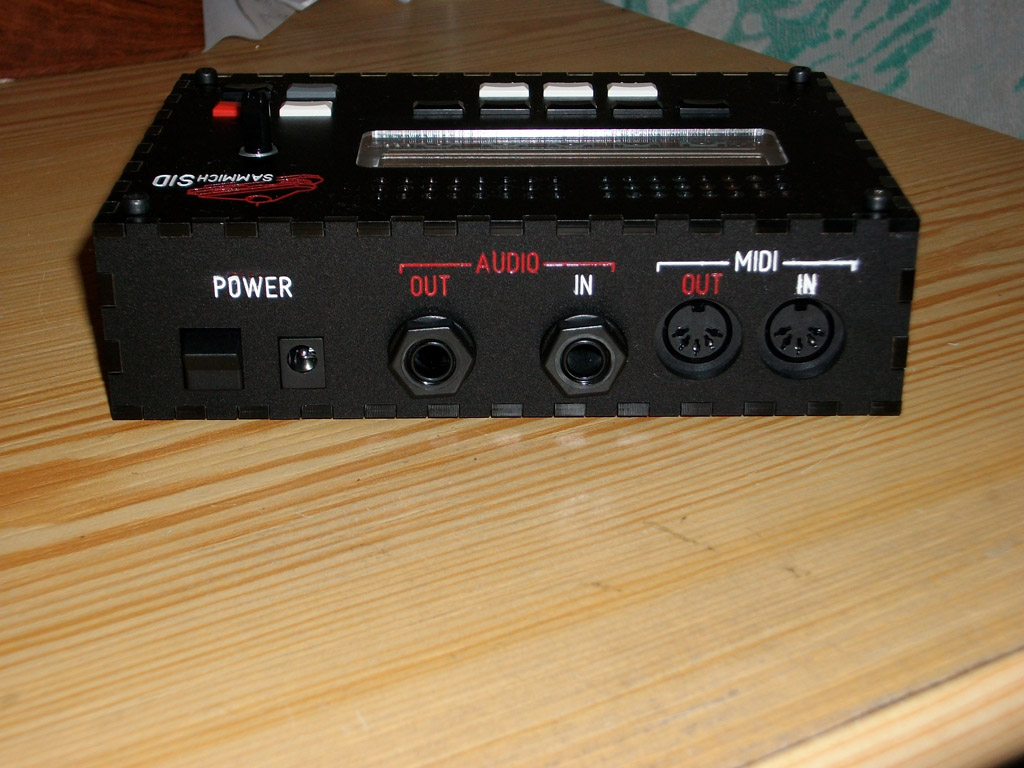

  10. Yes i have finished paint work last week ! Rear face : and Front Power On With some friends Merry Christmas Sid Freaks !

  16. Yep thanks, very good concept for future gig cause of his little size but big sound. I'm sure that sammichSID will be friend with my MachineDrum !! It seems to be a good combo !

  18. Yes !! i have resolved all my problems !! The last one was due to voltage of power suply, i've have increased the voltage and now sammichSID is completly functionnal !!! Now it's time to understand it and make some sound !!
