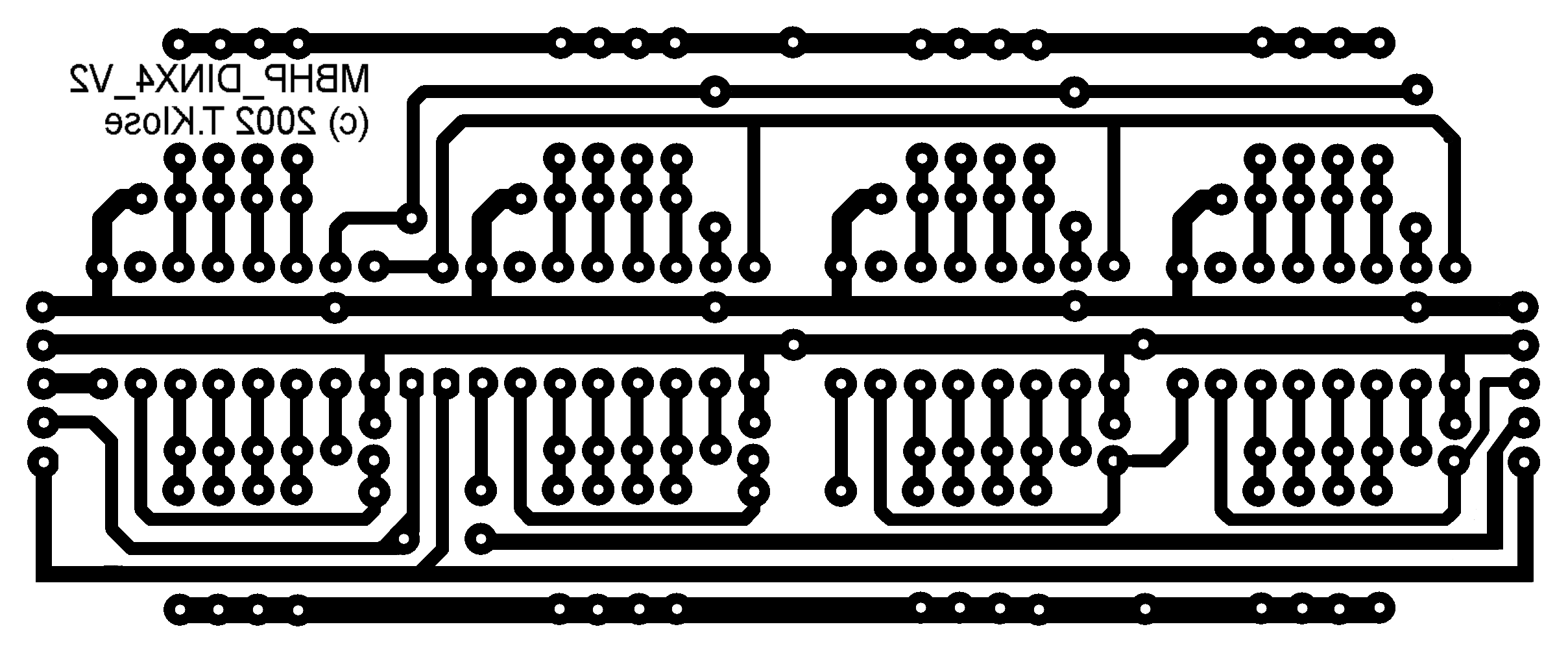

I haven't find answer in "Assembly Instructions" because of there instruction fo one-PCB assembly. Also i can't register there beacuse of maybe my email domain ".ru", forum write me: So please anybody who have account there please post there topic with my first-post question and give me link to read answers. Thank you. I have found this: www.eight-oh-eight.org/v3_Bottom_Copper.gif The legend for the above file: www.eight-oh-eight.org/Legend.gif yellow lines is dins, orange douts but picture is not full finished :(
Hi I'm try to build MB808 in this simple variant: And i don't find how to connect buttons, encoder and LEDs to DINX, DOUTX modules. What of DINX channel belong to shift, alt, A,B,C,D buttons etc, and where is encoder must be connected ? Also firmware for this variant is setup_808_default.hex or setup_808_tk.hex or ?
Also i have see now. 1 of wire is not necessary. It bridge between "second" register 10pin and "third" register 9 pin. It bridge available to make in PCB. It's authors little "bug"
I think maybe it will be useful for somebody (no so precision for handmade as authors variant). NO changes in electrical. Contacts is now circle and some lines is more thicker 600x600dpi attached
Thank you! One of the LEDs is 3-pin (2 color LED). One part of it is knobs-only midi-activity LED (LED4), second color is for switch (LED3 = S1). Other is: S2 - LED5, S3 - LED6, S4 - LED1, S5 - LED2 Today i have released english-interface software and new firmware: http://avargesnano.narod.ru/MIDI-DJ-CJ-CONTROLLER-2.0-USB-14.02.10.zip (page http://avargesnano.narod.ru/MIDI-DJ-CJ-CONTROLLER-2.0.html ) *Software has crash on the start if no MIDI input devices is in the system (so i start it after connecting my device). i will fix it in new version.
