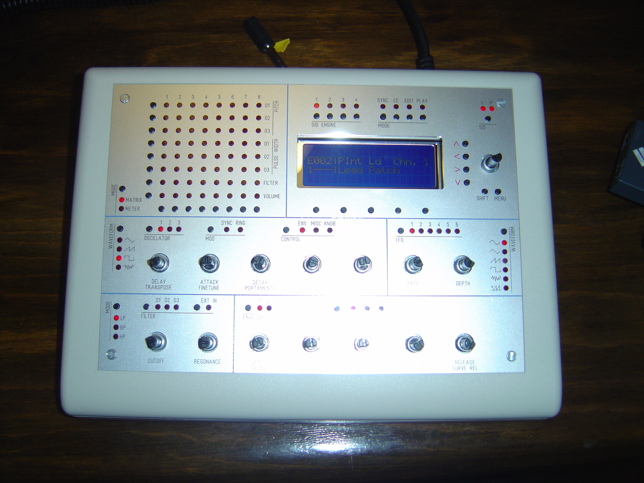

Hello Midiboxers. Heres some pics of my new MB6582. It sounds awesome. :thumbsup: I would like to thank everyone on this forums for your help. I would especially like to thank: TK, Wilba, SmashTV, Hawkeye and nILS. I still need some knobs for the CS, and I would like to go with som Korg Mono/poly style ones. But they are hard to find. My LCD backlight went dead last night, and I think I need an new LCD. Maybe one with a different shape to put the display closer to the CS. Oh and it is stuffed with 4*6581 ('83-'84), 1* 6581R5 ('86) and 1* 8580 ('90). I'll need at least one more 8580 to get that awesome stereo sound. One thing that surprised me when I booted it for the first time was the amout possibilities with the Midibox SID v.2. software. It is pure awesome. I took the liberty of adding my MB6582 to the officiel build list as the latest (127). I hope it's okay. Lastly. Thank's for making this possible guys! Sorry about the "whiteout" on some of the pics. My Blitz is too hot. And sorry about the (at times) dumb questions. :geek: Heres a small recording I did as my first sound test. The drums are Waldorf Attack and I used the sysex editor for SID manipulation. Please listen to the Vimeo version, as the Youtube one sounds like Sh*t. Suicide Sushi
