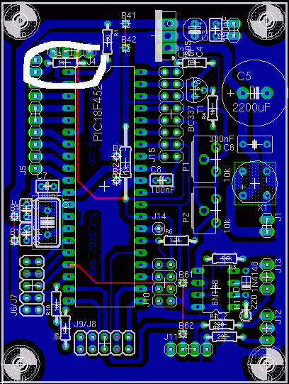

NeelG Posted October 8, 2014 Posted October 8, 2014 Hi, Im trying to upgrade to v3, not v4. Now where does the 1k pullup resistor exactly plot its two legs on the circuit of v2 , i dont understand the schematics but i do see where J4, is up at the top. Can anyone please help me understand where the 1k pull up resistor goes, and if i dont do the 1k pullup resistor what will happen when i migrate, i dont mind losing bank stick memory, but yeah, i dont understand where to put the 1k pullup resistor is there any real world pics on the two variances so i can see the difference.. of v2 vs v3 core. ? Thank you. Hope funky music is made for us all. Im attaching a v3 schematic with where i think the 1k pull up resistor is on v3 board , but on v2 i dont see where to plot its two legs, do the 1k pullups have to go a certain way? is there a left and right to the legs of it.?
Imp Posted October 8, 2014 Posted October 8, 2014 If your board looks like what you posted, you already have a CORE v3 (which was part of a Seq v2) and don't need to add a pullup. If you have a CORE v2, you can find its schematic at http://ucapps.de/mbhp_core_old.html. Find out, which pin of J4 is SC. Connect one leg of the resistor to the pins solderpoint at the backside of the pcb. The other leg goes to the +5V supply line. The direction of the resistor doesn't matter.
