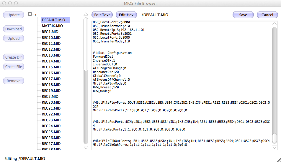

TK. Posted December 4, 2012 Posted December 4, 2012 Hi Marton, very nice! :) Next time you could edit the file directly with MIOS Studio: Or you could download, later upload it for modifications via Excel Best Regards, Thorsten.
