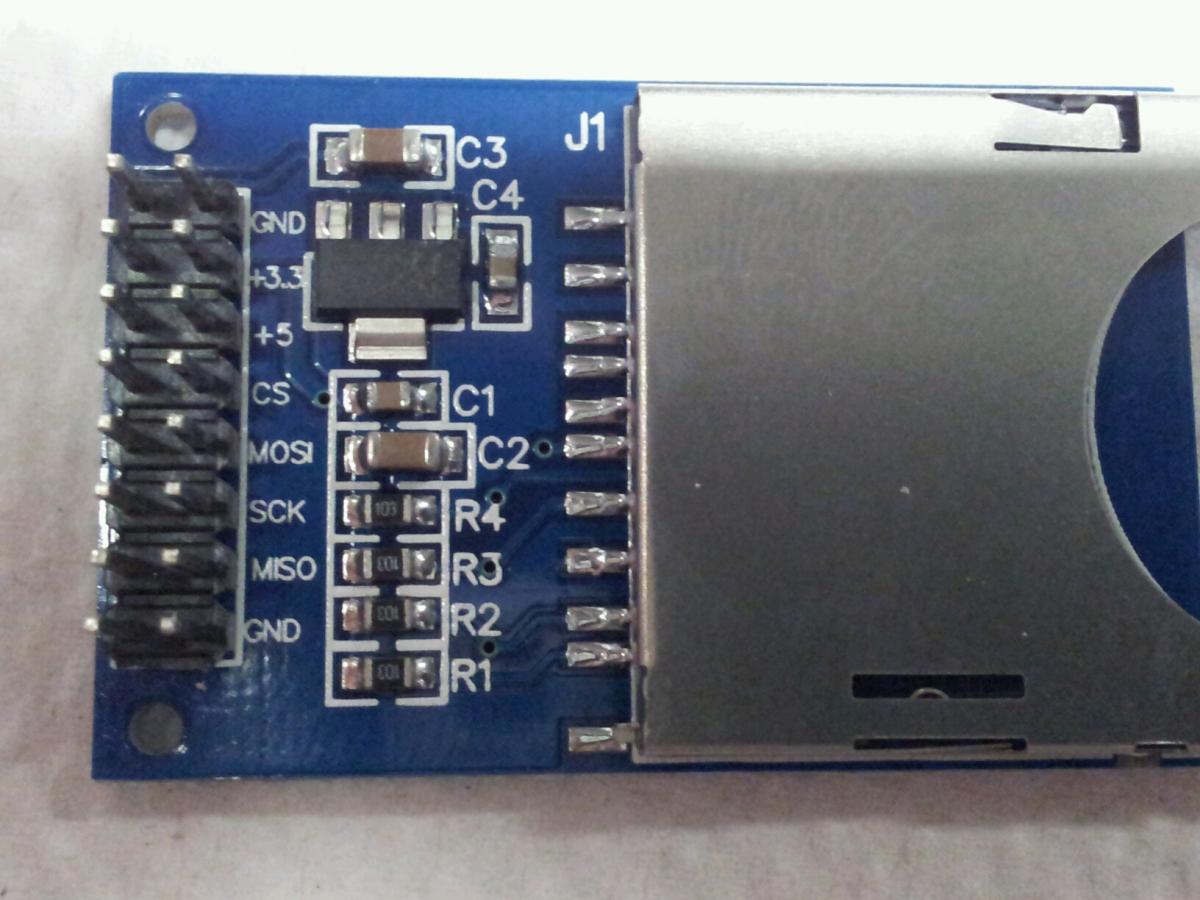

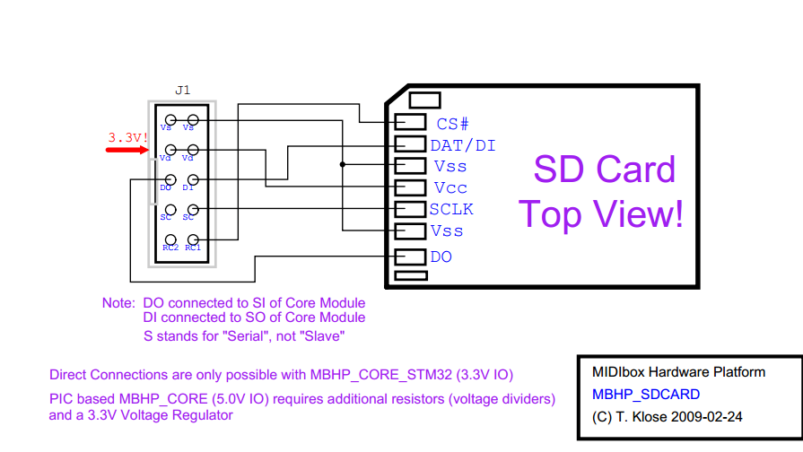

cosmosuave Posted February 10, 2014 Posted February 10, 2014 (edited) Hey I need some help translating the pin out from the SD card reader that I purchased to the pin out of Thorstens... Some of them match but then some have a different naming convention and i am unable to figure out by following the traces on the reader... BTW I got the card reader from Deal Extreme... This place has lots of stuff cheap and free delivery... I have bought lots of cables and a Arduino development kit for $50 from there... Thanks... bri. Edited February 10, 2014 by cosmosuave
SMIDIRIN Posted February 10, 2014 Posted February 10, 2014 Looks the same as the 1 i am using. The main thing being you just connect the 3.3v and ignore the 5v. So try this: cs=rc1 mosi=so sck=sc miso=si
cosmosuave Posted February 10, 2014 Author Posted February 10, 2014 Thanks guys your the best.... Have bookmarked that link...
