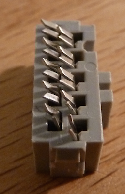

novski Posted November 17, 2014 Author Posted November 17, 2014 I found a part of my problems. :no: Some weeks ago i invested in a IDC Plier. That was already to late. The cable was made bevor and i don't know where i used it already without success. :pinch: Never use a normal Plier. I will come back to the Ids soon. Have to test it tomorrow.
