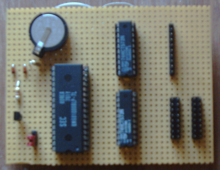

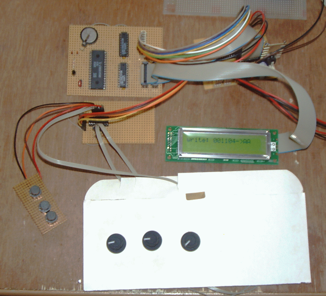

Hehe, my prototype is up and working.  ;D
Currently without battery backup but I will test this momorrow or monday...
Posted
Yes, did it quickly on breadboard.
Two latches and the remaining address and control pins directly to J5....
I will post wiring diagram,pictues and my test program tomorrow the next days.  ;)

Current status:
Yesterday I soldered the battery backup circuit and yes the SRAM kept the data since yesterday with only the battery... 8)
Before releasing the schematics I want to do some more tests.
For example I'm currenrly using a SRAM with 55ns access time, I want to try it with the more common type with 70ns. (this is only a software driver thing)
Also I've no 512k x 8 SRAM at the moment, I think this sould be tested, too. ('I'm using 128k x 8 currently)

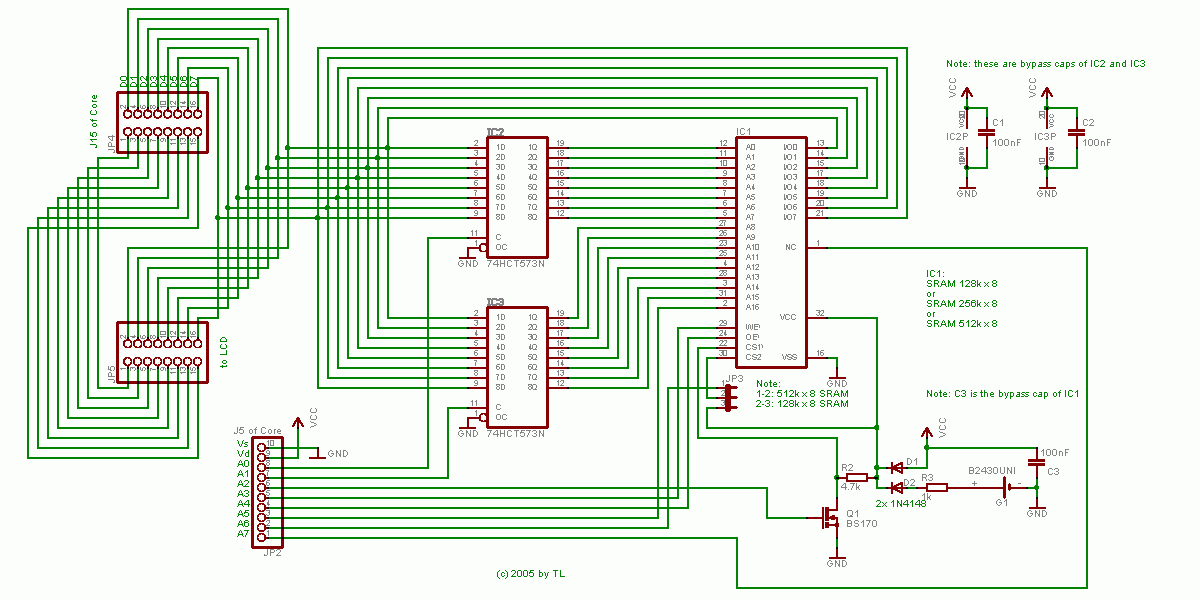

@stryd_one:
this is nearly the same schematic, only with serial interface.
@all
everything works, the only untested thing is the 512k x 8 SRAM, but this should work to 99%  ;D

@SmashTV
Can I send you the eagle schematic file?  ;)
Schematic
Some pictures
