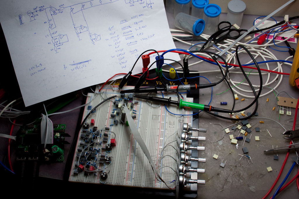

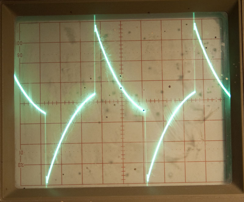

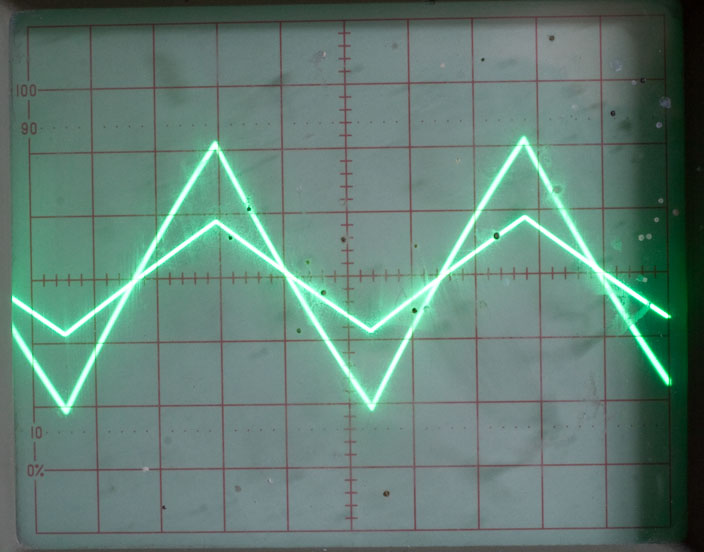

Meanwhile I managed to build 8-channel 3-band Butterworth filter to feed each channel to a single PGA. I'll
connect the three per-band outputs together (hoping there are no big time differences between the bands, using an
osciloscope there is a difference but it seems to be the same for all bands) and employ the 4th PGA input to be used
for per-channel master gain control. I've received 4 PGAs yesterday, expecting another 5 free TI samples arriving
today, waiting for a SOIC ZIF socket to test everything (two channels for start) on a breadboard or vectorboard.
I'd like to make output section configurable therefore would like to build a patch-panel to mix individual channels
to resulting output buses, I need to test this as well since I'm unsure how many outputs can drive how many inputs.
I'm still unsure how many PGAs will be needed for 4 buses (2x L, 2x R) with individual per-channel pan control. If
there would be no pan one PGA (4 inputs would suffice). I didn't peek into sources yet so I don't know how was
your pan implemented (whether two opposite-bound channels to lower left while raising right and vice-versa), but
I'd say there is a better solution for sure.

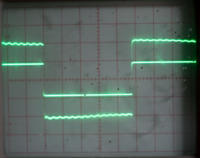

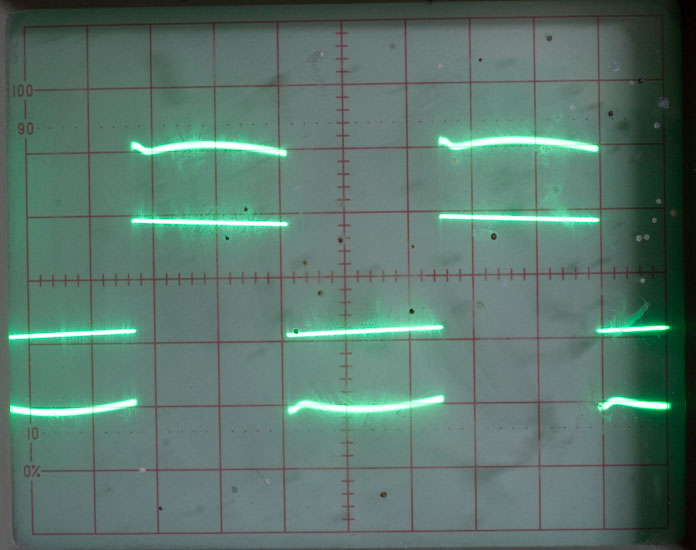

Up till now I as experimenting with different filters. First, I used a simple 3-channel Butterworth filter (http://users.otenet.gr/~athsam/3_way_active_loudspeaker_eng.htm) but this one suffered from phase shifts and time delays. The resulting sound distortion was audible even by me, this is a 6dB/oct 1st order filter with no linear phase, so this is obvious. Too bad for me that I already bought components for several channels. I'll try to reuse them. Hmm, it's been quite a time I left the uni and I wonder where my calculator is?!
Currently I'm using 3-channel linear phase response crossover filter (http://users.otenet.gr/~athsam/3way_active_crossover_with_linear_phase_eng.htm, really a great spotted site, Lyle!) built on a vectorboard:
(I managed to fry few of the chips, does anyone know if TI keeps records of the sample they sent? Can I ask for more samples? :rolleyes:)
For simple sinewave the crossover works as a charm for the entire 20-20.000Hz spectrum, but for more sophisticated waves (triangle and pulse) the resulting output is distorted:
(1kHz triangle)
(1kHz pulse)
The waves remain far from their meant-to-be shape regardless of filter trim-tuning... Hopefuly someone with audio (and mathematics) skills can tell me what harmonics are missing or are much too loud...
However, for really complex waves (music) the distortion is barely audible (at least by my ears and more-than-average quality headphones).
One more thing to ask for, if the troubles are solved and I'd be thinking about building the PCbs for multiple channels, I wonder if anyone could help me with PCB routing? Of course, I'd give out the schematics in Eagle but I'm really unskilled with PCB design and effective components layout. I'd really be thankful if anyone could give a hand...

Hmm, the osci is set to DC (I didn't see any difference for sine wave, that's why), I'll change it to AC. I didn't catch the difference, anyway :rolleyes: . I'll take a test look in the evening, thanks for hints so far :rolleyes:
Do you use a amplifier?
If you consider PGA being an amplifier, then yes, but the freq response should be okay for PGA, according to datasheet and web page it's used in professional audio application. Anyway, the interconnection looks like: Functional generator -> filter -> PGA -> Oscilloscope.
I never checked whether the output of filter directly is distorted for non-sine signals or not (I doubt it'll be distorted), I always connected the osci after the PGA amplifier. I'll do that when I get back home.
I did more checks meanwhile and found out, that when a signal passes through a single filter (>10kHz, i.e. only HPF is involved), the signal is distorted as well (measured at PGA output as mentioned above), do the phase and delays are not involved in this case. I'll see tonight whether the filter output itself is distorted or whether PGA adds the distortion...
Edited by freddy
It makes sense that the signal looks distorted. A sine wave will probably be passed through one filter only and thus there is no risk for interference due to phase differences. The other signals are composed of many frequencies. To get a complete square wave out you'll need to have the output of all filters added together, in phase. Thus, if you take the output of one filter only, it will not resemble a square wave, especially not the HP-filter. Attached a matlab plot of a hp-filtered square wave. Excuse me if this is old news...
Posted
Strophlex,
the reason why a filtered non-trivial wave (triangle/square) is distorted is clear to me, the formulas can be found on Wiki or in my school notes. This is not the case, unfortunately. Well, it is, but this is obvious.
The problem in my case is that (after new measurements were done) non-filtered complex wave is distorted. In the attachment below, there are two 10kHz waves passing through filter and measured at filter output. The HPF crossover point is 2kHz, so the waves are far above it (10kHz), therefore passing only through HPF. Since they're for some reason distorted already at filter output it's clear that PGA can't do anything about it... I only have one osci probe so I cannot make ALT snapshot of the two waves, but I'll get second tomorrow, promised! :rolleyes:
Maybe this is given by the filter construction - I don't know the english word but the filter itself consists of two LPF filters (and time delay units) and the filtered signal is substracted from the original signal in subsequent stages, so since there is phase difference (if phase difference is what I see on the osci) - this is the only place distortion can occur. This filter was chosen since it has 'linear phase', but apparently 'linear' doesn't mean 'flat'... Apparently, I need to make more filter experiments, anything to suggest? Bessel filters seem to have flat phase delay, they'll be probably my next choice for testing...

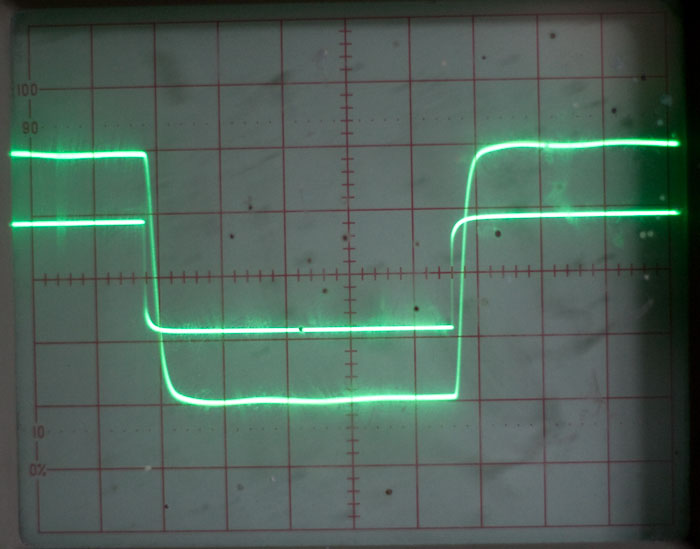

What is interesting to me is that for 100kHz the waves are much more what they should be. Is there an explanation for this? (See latter two thumbnails)
Posted (edited)
So these signals have a frequency of 10kH and 100kHz and where sent through a hpf with cutoff frequency of 2kH? Looking at the square waves, I think they look low pass filtered, the 10kHz one more than the 100 kHz one. Is there some low pass stage in the filter you sent them through? In that case the 100kHz signal should be more affected then the 10kHz so it doesn't make sense. It's still early here so my head is not started yet. Anyway, I think the second osc. probe will show something.
EDIT: I looked at the wrong pictures... Both square waves look hp-filterd. Looks like a hp-filter with cutoff frequency at well above 100kHz. Did you look at the signals through the amp only yet? I don't understand this
"Since they're for some reason distorted already at filter output it's clear that PGA can't do anything about it... "
Sounds like you assume the hp-filter works. Why not just connect the scope to the output of the amp if you didn't do that allready.
Edited by strophlex

The waves above were measured with this testing setup:
function generator -+- LPF
                    +- BPF
                    +- HPF -> oscilloscope
Since the waves were 10kHz, resp. 100kHz, besides the "substraction" filter construction, I'd assume that the signal passes only through "HPF" though "HPF" is composed of two "time delay" units and summing unit (confirmed by the oscilloscope - no signal was on BPF or LPF).
Hmm, looking at the schematics (here, for quick reference), the BPF takes input signal, filters high frequencies using 3kHz LPF and substracts the already filtered LPF signal, resulting in band-pass filter 200Hz-3kHz. Following the same logic, I'd assume the HPF should take delayed input signal (connected to positive input of IC7/B) and substracts BPF signal (connected to negative signal of IC7/B). The delayed signal connects to negative input, however. Am I missing something? If there is no reply for this during the day, I'll try to connect it (as it makes sense to me) in the evening... Strange thing for me is, that the filter does actually work, for sine wave, that is.
Again, not sure what you consider being an 'amp' - op amp? The osci is connected either directly to filter outputs (i.e. op amp outputs plus some resistors/capacitor) or after all PGA channels, which has all the filter outputs mixed. The snapshots in my previous post were done with osci connected directly to filter output.
Thanks!

Hi,

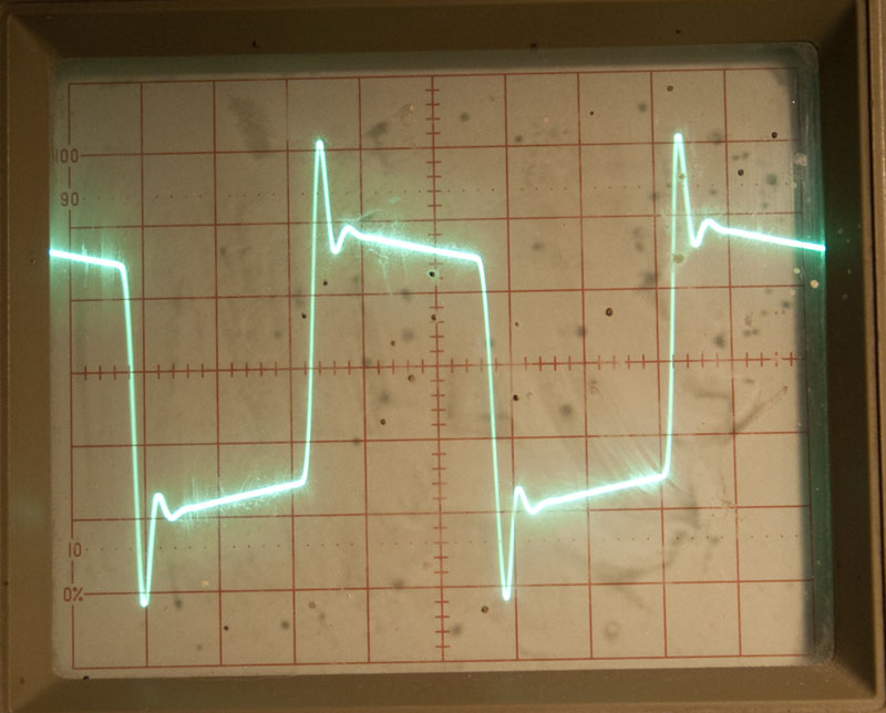

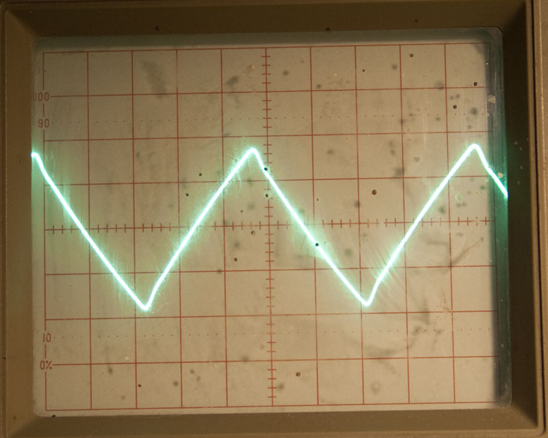

after several unsuccessful tests with different filters and crossovers I've decided to go for basic 6-band equalizer. For setting the per-band level I'll use digital potentiometers. Since there are 6 bands I'm going for Analog Devices AD5206. The equalizer is a standard one with op-amp input and output buffers and gyrators to substitute inductors in LC pass-band filters. The component values to be used were computed based on my in-shelf supplies to re-use maximum amount of filter capacitors bought for different filter and crossover attempts, but basically the bands are 50Hz, 100Hz, 200Hz, 800Hz, 3200Hz and 12800Hz. Resulting audio signal will be connected to two PGA channels (left/right) to control channel volume. The mixer will be controlled via MIDIBox 64 (or 64E, though 128/128E would be useful for controlling 8 parameters for 16 channels :rolleyes:).
THe AD5206 uses the same SPI control bus as PGA4311 is using, so I'll start making the modifications to the software as soon as the equalizers and PGA channels are build. There will be 16x AD5206 and 8x PGA needed for 16 stereo channels plus additional 2 PGAs for total 4 stereo output buses (as mentioned in the previous posts), so the SPI bus control signals (CLK and /CS) will definitely need to be buffered.
For results see the thumbnails below, they are (in the following order):
- response for 100Hz sine wave, the original (unmodified) wave is cut down in half to see both waves
- response for 100Hz triangle wave with original cut down
- response for 100Hz pulse wave with original cut down
- response for 100Hz "equalized" pulse wave with original cut down
- response for 1kHz pulse wave with original cut down
- response for 10kHz pulse wave with original cut down
- my current desk top with the EQ circuit built on vectorboard (no PGAs and no AD5206s yet)
A slight distortion can be seen on all waves (because of shutter speed you may notice the higher-amplitude signal being "thicker" than the other one), it can be seen best on the 1kHz pulse wave. According to the tests performed this is caused by the wires connecting potentiometers with rest of the circuit, there is no ground on the wire. When AD5206 will be used, I'll take care and make the audio lines as short as possible, when possible with analog ground surrounding the lines.
Wish me luck...
Posted
Hi,
Wish me luck...

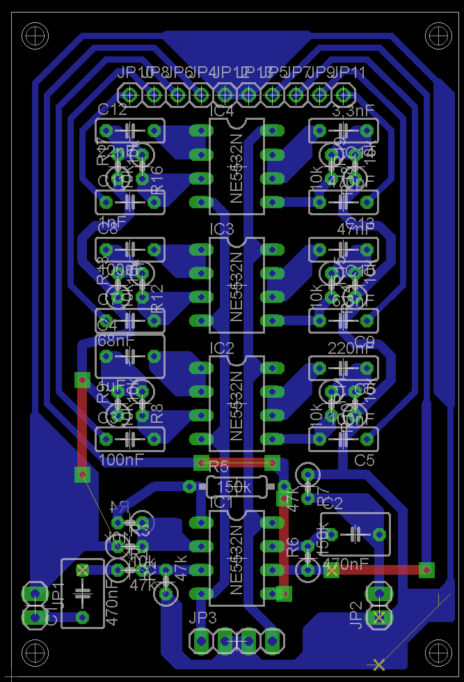

So here are all the schematics and PCB designs, I was busy designing and creating the PCBs during Xmas (I luv Xmas :rolleyes:).
However, after building the EQ prototype I found out that it's much too noisy, even with no pots connected I'm unable to get square output from square input... The best result is attached down there. Apparently the PCB design causes the noise (however there was no noise when the EQ was built on a vector board), are there any audio PCB design rules I should be aware of? I'm planning to use shielded cables for connecting the pots, I can also try leading a grounded isolated wire between each two audio signals for test (input, output and pot connections) next to analog ground? I can try to modify the already-built PCB but would like to know whether it actually helps before I re-design (and etch) the PCB...
Below is the EQ PCB design as well for quick reference.
Thanks.
P.S. If anyone is thinking about building such mixer I'd encourage to use AD5204 instead of AD5206, though more ICs will be used AD5206 has no SDO signal and doesn't allow chaning, that's the reason for all the /CS logic found on 2nd sheet... I do already have 20x AD5206 so this is no choice for me :wacko:

Wow, great progress!
I am just learning board design for audio, Maybe some of this will help:
You should have one (or more) bypass capacitors at each chips power pins. These should be as close to the chip as possible.
This is true for digital circuits too, but even more important for analog stuff.
Try to avoid long parallel traces.. this can lead to "crosstalk" between audio signals, or even worse, from power leads to signal leads.
Ample grounding is important... as is shielding, but don't use the same traces for both. Shielding traces should be carrying no current.
The ground arrangement in the last version of the mixer had four separate ground circuits! The analog ground, for all op-amp circuit grounding
and the analog part of the PGA chips. The Digital ground for the digital parts of the circuit, the center tap of the power transformer, and
the "shield" circuit, which protected the signals but has no current path otherwise.
All 4 of these grounds were joined together in one place only, the center of the regulator board.
I also used separate regulators for the analog +5 and digital +5 circuits. to reduce digital noise.
Was it all necessary? Maybe not. but I wanted to apply everything I could to keep the board as quiet as possible.
Getting back to your designs.. I have not even opened the eagle files yet, but I see no bypass capacitors on the op-amp
board you showed a picture of. That might be a good thing to try.
Good Luck with this man, it's looking great!

thanks for comments, notes!
I wanted to place them directly on the IC pins on the copper layer, but right, they're not found on the PCB.
I doubt these can be avoided in case of a single 6-pot connector, but I've placed ground plane between each two signals. There are still power leads really close to IC pins, I hope these will not cause much damage.
In this design, the EQ is purely analog part so I'd think a single AGND is sufficient. Furthermore, the 'ground shields' leading between audio signals are not leading anywhere so they might really be considered 'shieding traces' as mentioned above.
I have these, too. A weirdness happens when I connect grounds of the two power supplies (+/-5V analog and +5V digital) - the analog PS starts drawing as much as 100mA (@230V), but luckily I have lab PS to test with. Power supplies will be designed in the end when I know all the currents needed and all the place available.
I'm diving back into Java this morning to try and get the mix window ready for release.
Once the hardware prototype is ready I'll start programming the DigiPot (AD5206 in my case) part, rest is done already including bus switching. I have also modified the Java for testing, I'll send it back to you if you want it, but as discussed elsewhere, there were just minor modifications - extending channels and adding few more controls...
I know the PCB still is not perfect, but a little go/no-go might help :rolleyes:
