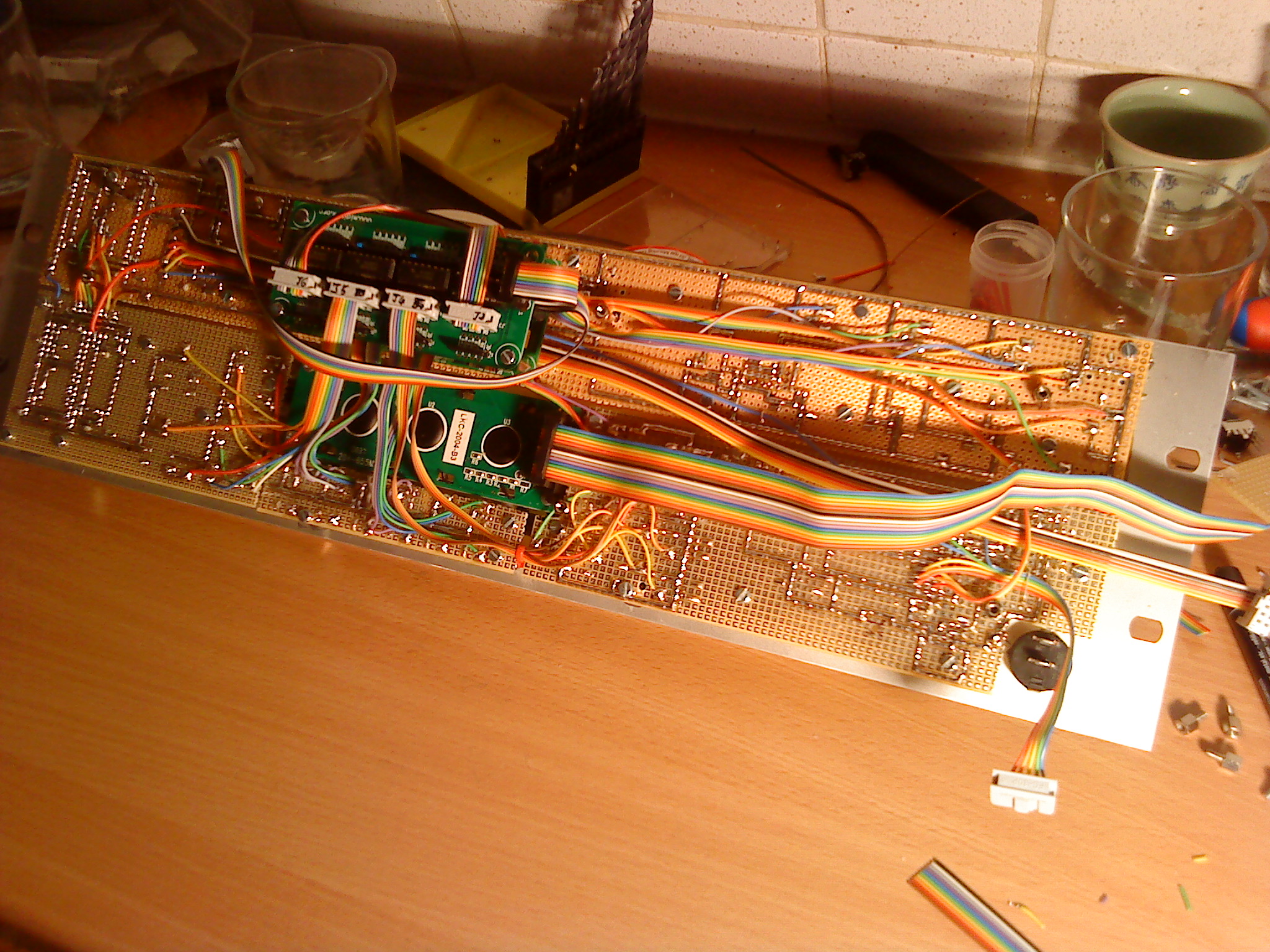

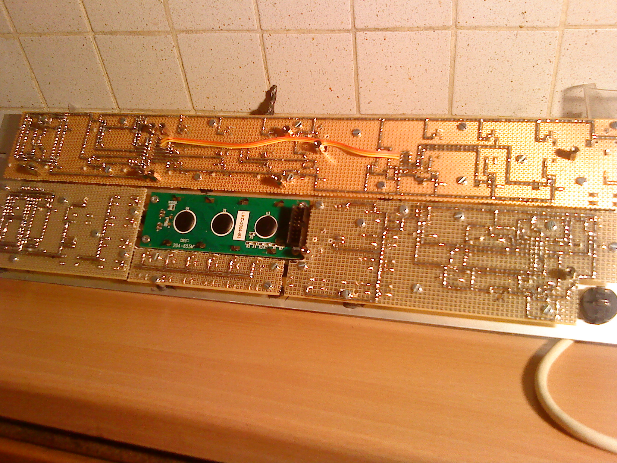

julienvoirin Posted January 18, 2011 Report Posted January 18, 2011 (edited) Dear Patrick It has been a year now and I wish you a happy new new year :ahappy: So, i've just finished my matrix1000 controller, essentially based on your nice design. I 've added some additional buttons, but for later. SO, i've got a problem : i downloaded your source files but as i did not follow your design (AIN, DIN and DOUT pins placements differ in fact) i've edited pots.h and din.h to correspond to my design but it seems that it doesn't do the trick :getlost: i just type make in Mac OSX terminal, in the corresponding folder, as i do for other app I am absolutly sure about the pin numbers because i used the ain64_din128_dout128 app to note the pin number. Each button, each LED, each pot is responsive, so my hardware is correct. I think that the major problem sits in the compile process on my computer. Is there anything to clean do you think ?? I already cleaned /ouput but doesn't do anything ... I would be pleased to get some of your help Best regards EDIT : I've uploaded my .c and .h files if somebody wants to observe the difference between my config and the one of JackChaosMatrix_Controller.pdfdin.cdin.hencoders.cencoders.hpots.cpots.h Edited January 18, 2011 by julienvoirin Quote
julienvoirin Posted January 18, 2011 Report Posted January 18, 2011 (edited) after several hours into code, i think i've maybe understood : Din buttons are not defined into .h but into .c, isn't ? in .h, we define the place in the array, isn't ? EDIT : Problem solved In fact your app uses a double double array if i well understood : 1st array defines DIN/DOUT pin connection in .h, linked to a second array for display in .c 2nd array is for AIN, same "way of making things" than for din/dout I am right ? All the code is very very well constructed and well thought :thumbsup: Edited January 18, 2011 by julienvoirin Quote
jackchaos Posted January 18, 2011 Author Report Posted January 18, 2011 Julien Congrats on getting this far! Are any of the controls working... pots, leds, encoders? Its been a while since I looked at the source but taking a quick look... Apologies, the DIN/DOUT config could have been made cleaner. Yes you will have to edit both din.c and din.h to config pins. din.c: Has to be filled in (DIN_ConfigMap[32]) The dins need to be listed in order that correspond to their pin number in the array. And of course each entry must point to the the DOUT pin for its corresponding LED. din.h has a few of the pins in din.c #defined to improve code readability wherever its used. So make sure anything in din.h that starts off with #define DIN_ or #define DOUT_ pots.c: Rearrange the entries in PotConfigMap[] to correspond to their pin positions. Then edit the #define POT_OSC1_***, POT_FILTER***, etc. in pots.h to match their config in pots.c Quote
julienvoirin Posted January 18, 2011 Report Posted January 18, 2011 Are any of the controls working... pots, leds, encoders? Yes ! except Filter Sustain certainly cause buffer is empty (not yet connected the matrix 1000 to) :sweat: Apologies, the DIN/DOUT config could have been made cleaner. it's OK, i've understood :ike: din.c: Has to be filled in (DIN_ConfigMap[32]) The dins need to be listed in order that correspond to their pin number in the array. And of course each entry must point to the the DOUT pin for its corresponding LED. din.h has a few of the pins in din.c #defined to improve code readability wherever its used. So make sure anything in din.h that starts off with #define DIN_ or #define DOUT_ pots.c: Rearrange the entries in PotConfigMap[] to correspond to their pin positions. Then edit the #define POT_OSC1_***, POT_FILTER***, etc. in pots.h to match their config in pots.c I am so excited :frantics: !!! Would you be OK to help me to implement : 1. Connection to Matrix through I2C, normal core MIDI reserved for notes only ? 2. Bankstick support : all parameters stored in the small EEPROMs instead of the Matrix EEPROM ? 3. Multiple Matrix control (I've got 3!) thanks to 4x I2C ? 4. Arpegiator , synced to midi clock? I wanted to ship you a IIC module and a 8 bankstick stuffed PCB to help you when you were trying the Merge stuff. PM your postal adress if you are interested Btw, I really want to prove you my big big big respect for this app, all this so clear code (a good base for Roland Juno PG300 clone :thumbsup: ) and all the doco you've published in the wiki Next step is silkscreening of the panel and Re'an P301 knobs dealer (maybe eBay if the guys answer me one day) Thanks again :hug: Quote

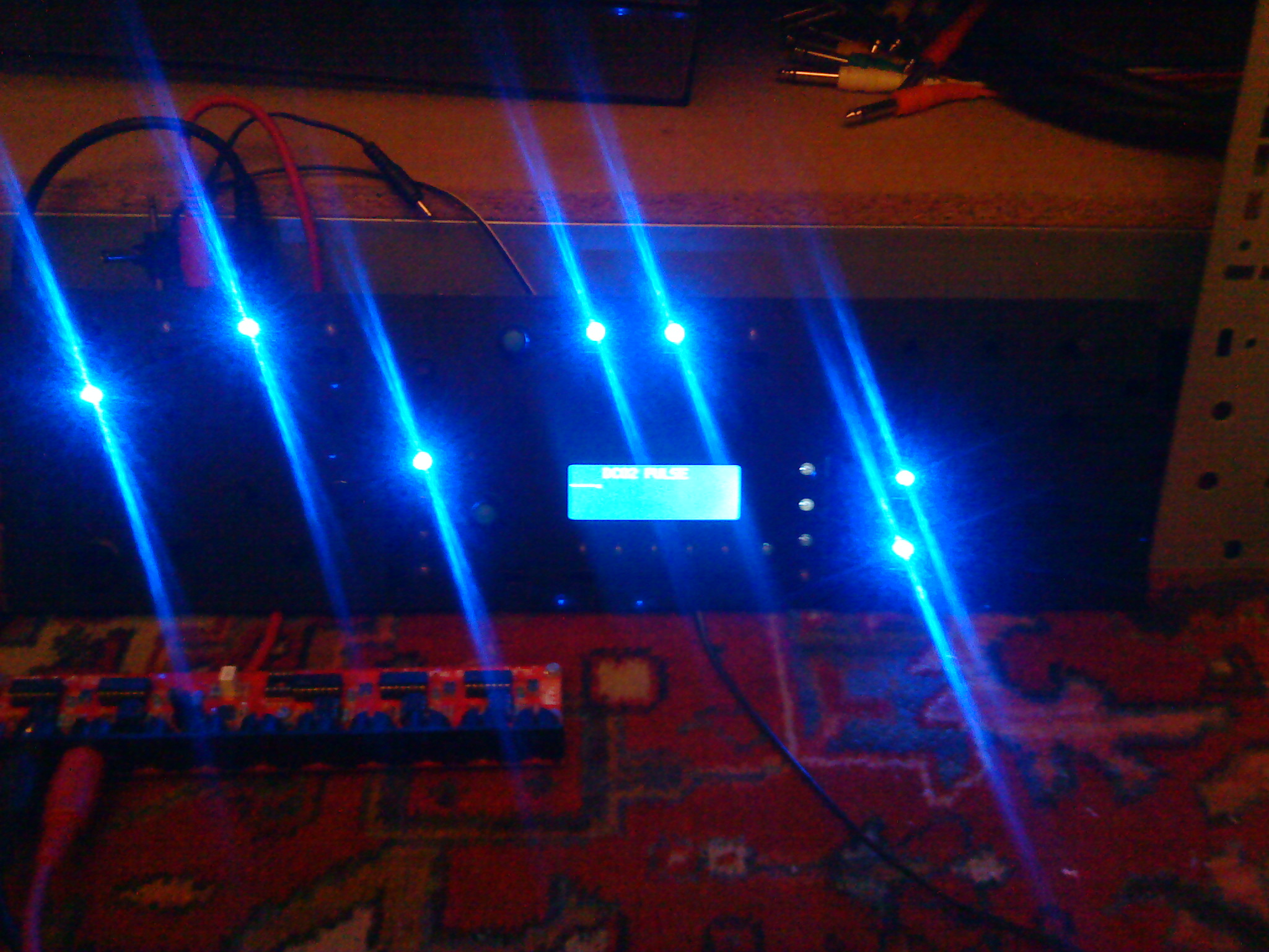

julienvoirin Posted February 9, 2011 Report Posted February 9, 2011 (edited) 1. Connection to Matrix through I2C, normal core MIDI reserved for notes only ? DONE ! i2c out only as the programmer will manage patches data 2. Bankstick support : all parameters stored in the small EEPROMs instead of the Matrix EEPROM ? DONE ! tonight it reads and writes into eeprom, writes into bankstick ; tomorrow i will implement read from bankstick the programmer can ask a patch dump from the matrix1000, then you choose in what bankstick memory it goes (8x100 patches, later 2x8x100 patches) 3. Multiple Matrix control (I've got 3!) thanks to 4x I2C ?DONE ! using a sort of router algorithm (event of 1st channel routed to 1st i2c and so on ..) 4 buttons allow you to edit 4 matrix 1000 independantly next enhancement will be 4 EditBuffers for each matrix :thumbsup: thanks again to jackchaos :heart: for his so well structured code ! lots of useful functions are implemented and useful for enhancement and thanks to the genius who created "SysEx Dump Demonstration (and template)" :ahappy: very useful to read/write into BS Edited February 9, 2011 by julienvoirin Quote
jackchaos Posted February 9, 2011 Author Report Posted February 9, 2011 Julien Is it working with 1 Matrix 1000? Is the edit buffer working too? I'm looking forward to seeing the product of all your hard work on YouTube. At least a demo of the controller and 4 Matrix 1000's. Quote
julienvoirin Posted February 9, 2011 Report Posted February 9, 2011 of course it works ! the edit buffer is working as it is the one you've developped ! :whistle: i test each stuff with one matrix for audio, and analyse every internal and i2c out for MIDI it is based on ultracore (a core+ 8bankstick+4 IIC modules, all on one PCB) Quote

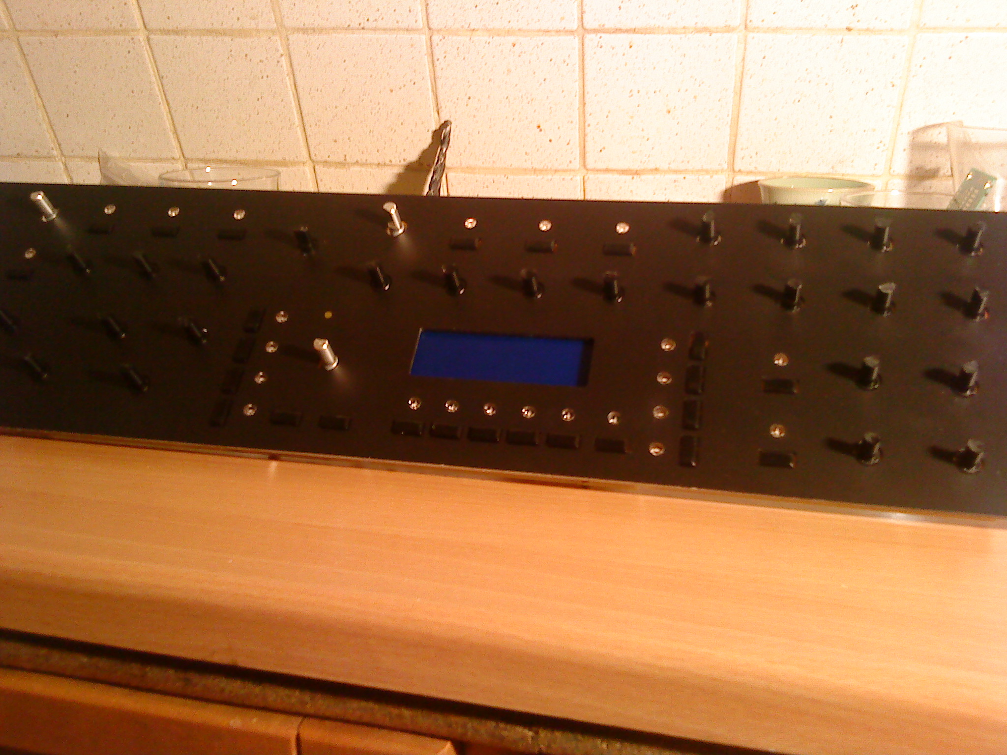

julienvoirin Posted February 11, 2011 Report Posted February 11, 2011 (edited) It tooks me 4 days, but I DID IT !!! now it reads and writes into bankstick :thumbsup: Some enhancements need to be done, but here is what you can do with it : - get single patch from matrix 1000 and store them inside bankstick (8 BS, each having 100 patches) - load a patch from bankstick, update EditBuffer (so that the LFO leds blink at the good rate for example), tweak it and resave it into bankstick Then the Matrix1000 is only a sound player, all is managed by the Chaos Matrix :rolleyes: still a beta code, UI needs to be improved. I 've added several pages to Patch management. If somebody see a good manner to dump a whole bank (100 patches) directly into Bankstick , i am interested. It can be done into void MIDI_HandleEditBuffer(unsigned char byte) of midi.c but it is a little bit hardcore for my poor experience of selfmade coder EDIT : v0.31 et v0.32 are buggy for bankstick save. beta v0.33 is OKMatrixBoxSource_JV_beta v0.33.zip Edited February 13, 2011 by julienvoirin Quote
jackchaos Posted February 11, 2011 Author Report Posted February 11, 2011 Looks like everything is coming along nicely. Congrats! P.S. You can attach files directly to your posts here, and later remove them if necessary. Quote
