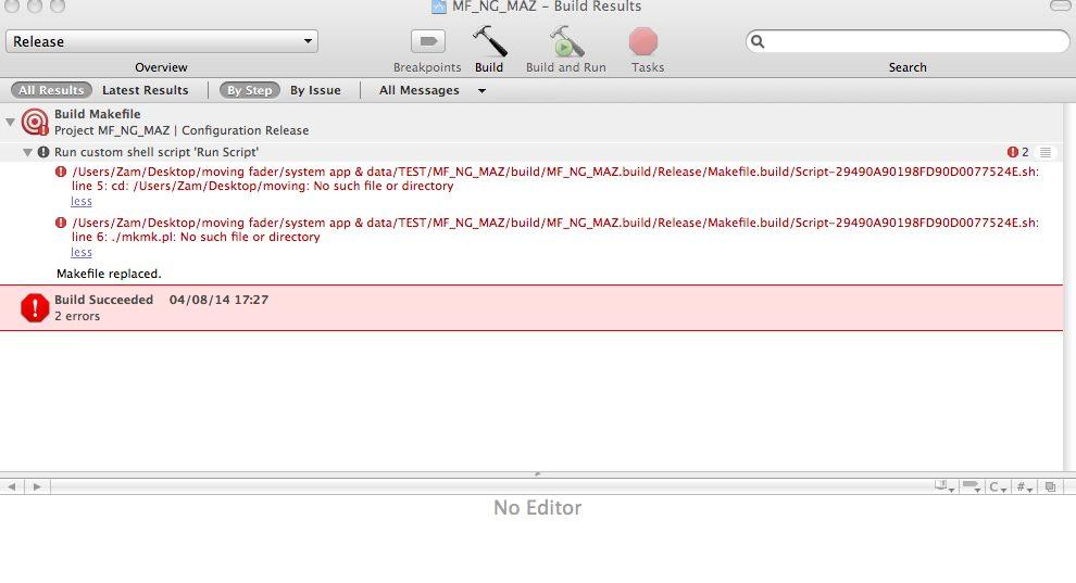

Zam Posted August 4, 2014 Posted August 4, 2014 (edited) hello I try again to compile trough xcode without succes :( Zam Edited August 4, 2014 by Zam
