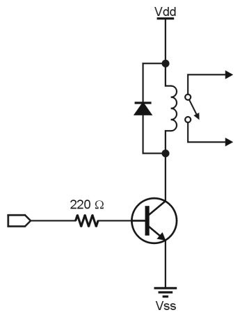

Dimitree Posted January 9, 2011 Posted January 9, 2011 hi everyone I've seen that the example on the website about how to connect a reed relay to the DOUT module doesn't use any transistor and connect the pin directly to the transistor (adding just the protection diode). I've always read that it is recommended to use a circuit like this attached to the post is it true for reed relays too, or it will work too if connected directly, with no problems? many thanks to all Dimitri
nILS Posted January 10, 2011 Posted January 10, 2011 The reason for adding the transistor driver is simply that regular relais need quite a bit of current to switch and that may be too much for the shift registers to handle. Reed relays seem to need less current which allows them to be driven directly from the shift regiter pin - whichever you decide to use make sure the current draw is small enough or add the transistor driver.

Dimitree Posted January 10, 2011 Author Posted January 10, 2011 thanks Nils, since I don't have much knowledge about electronics, is there a way to understand if there's enough current to drive my relay, with datasheets in the hand?
TK. Posted January 10, 2011 Posted January 10, 2011 You should find the current consumption in the datasheet, it should be less than 10 mA. Best Regards, Thorsten.
Dimitree Posted January 10, 2011 Author Posted January 10, 2011 yes it's (+/-10%) 10mA, so I guess at limit?
nILS Posted January 10, 2011 Posted January 10, 2011 technobreath: Yes it's possible, no I will not go into details of switching 230VAC in here. There be dragons, 230V is ouchy, especially if you don't already know how to do it :) dimitree: 10mA +-10% is within spec, you could/should use a resistor in series with the DOUT output (like for LEDs) to limit he current (330R seems about right and will give you 15mA).

Dimitree Posted January 13, 2011 Author Posted January 13, 2011 many thanks again, I guess I'll add on my pcb the space to stuff transistor too, so in case the pic won't be able to drive the relays I won't need to threw away the pcb :D next time I will search for <10mA relays
