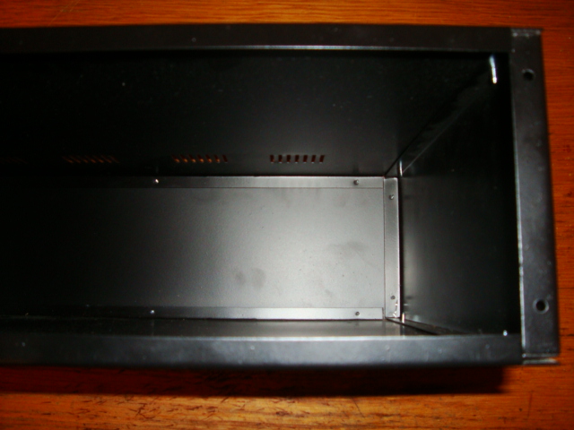

rosch Posted September 1, 2011 Author Report Posted September 1, 2011 (edited) thanks jojjelito. the banzai stuff looks similar like the thing i have. attaching a pic of the ridiculous construction of the case. my plan was to bring the core to the backside and use its stock pcb mount midi sockets (core with hex standoffs on bottom panel). there are only a few more pcbs inside, 4x IIC, 1x AOUT (MAX525), i'll make a small perfboard with the additional sockets from the IICs in one row - and, the gate output buffers you mention sound very interesting. but the whole gate thing is some more stuff i'll need to dig out the info about even how to obtain them from the core or aout, we'll see. well, the case is deep enough to just cut it in halves and take the angled sides for mounting the back panels (one of which will be the so called front panel, which is nothing more than a wobbly blind panel). i'd have to cut away the angles anyways in order to fit in the control surface board. then i'll most likely get me a decent 3mm panel from Schäffer and knock some mounting holes through the sides to mount it to some kind of brackets that i'll have to make, also in order to make the side panels more stable, though the weight will be reduced a bit when cut in halves. in german that would be called "geknaupt" Edited September 1, 2011 by rosch
