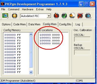

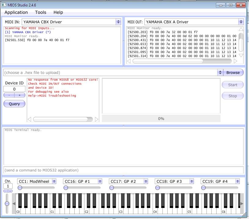

Los Zelos Posted December 25, 2014 Posted December 25, 2014 Hi guys, Im newbie in midibox, and i have problem with CORE module. I tried to find anwer in this forum, and i found one topic, where guy had short-circuit there. I found also one small short-circuit, but now im checked both PCB - LTC and CORE and i think that everythink is okay. I also read about ID field therefore i downloaded PICPgm Programmer and tried to power up. Still i only get this pictures: And ID field in programmer must look like this ? : btw .. I had shorted 6 and 9 pins of pic18f452 ... Is it real, that i send this output to silicon's sky ? I tryied everthing and im sad that i cannot continue in building ... :( therefore PLEASE HELP :( here is fuses from programer...

Los Zelos Posted December 27, 2014 Author Posted December 27, 2014 YESSSS !!!! I found mistake in ID Location. I have to burn chip with 0000 0000 0000 0001! The code 0000 0000 0000 0000 is only for MIDI interface , if you using LTC you must change location. I found calculator @ www.midibox-shop.com/idgen.html and tried to reprogramme device. After that Mios write me your board is connected ^.^ Im satisfied and happy that my board running up!! :)))

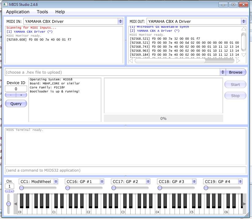

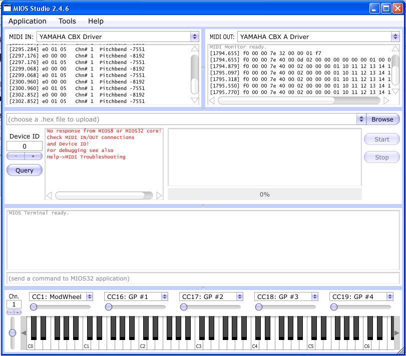

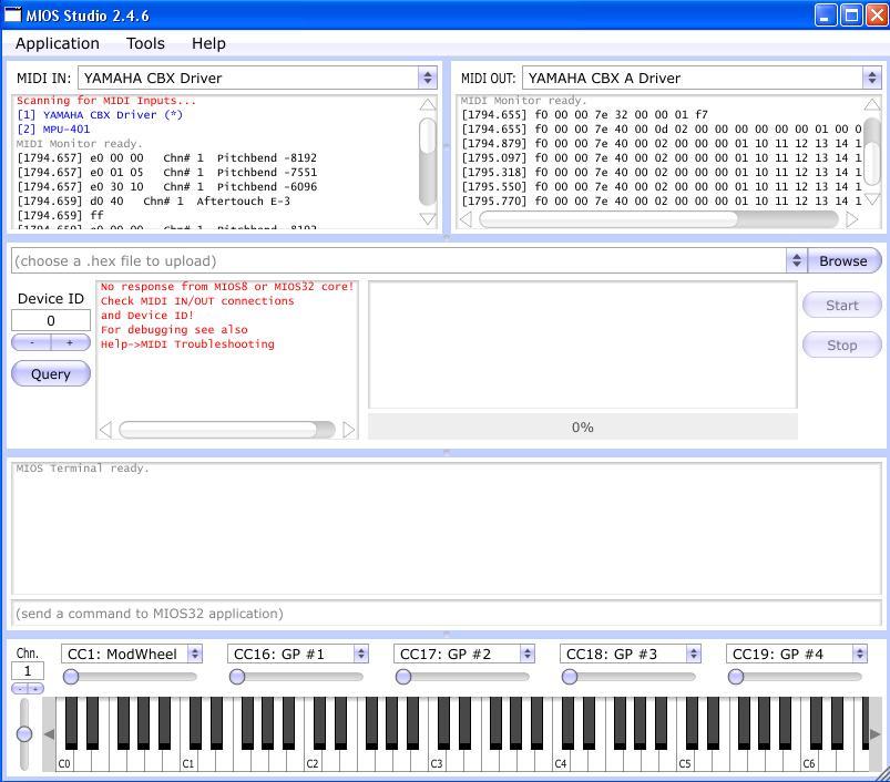

Los Zelos Posted December 27, 2014 Author Posted December 27, 2014 Okay, board runing up but i have still problem with stable connection. when i start mios studio board is connected sometimes mios show me : after when i restart mios studio , sometimes board dont want to run up and mios show me screenshot 2. when i want to upload project.hex via mios studio, MS show me : where is next wrong ??
TK. Posted December 30, 2014 Posted December 30, 2014 The LTC module was used back in 2000 as a cheap MIDI interface replacement. It was the time of Windows 98 and ME. Unfortunately today (15 years later!) the drivers don't work properly with newer windows versions anymore. :-( Use a cheap MIDI interface, it's more reliable! But please don't buy this one: http://www.ebay.com/itm/USB-IN-OUT-MIDI-Interface-Cable-Converter-PC-to-Music-Keyboard-Adapter-Cord-/271286969299?pt=US_Cables_Snakes_Interconnects&hash=item3f29f6a3d3%C2%A0 It's on the black list: http://www.midibox.org/dokuwiki/doku.php?id=midi_interface_blacklist Instead I recommend a "Neusonik uMIDI/O22" which is cheap as well, but very reliable. Best Regards, Thorsten.
Los Zelos Posted December 31, 2014 Author Posted December 31, 2014 Very thanks, i used YAMAHA driver, and , red diode blinking every 2 secons. First idea was that drivers don't work properly. But out data (sending green diode have normal function). I also bought new chip and reprogramme with bootloader, now after complete check board and i dont know, where is mistake... I try to buy your solutions. Again thanks!
