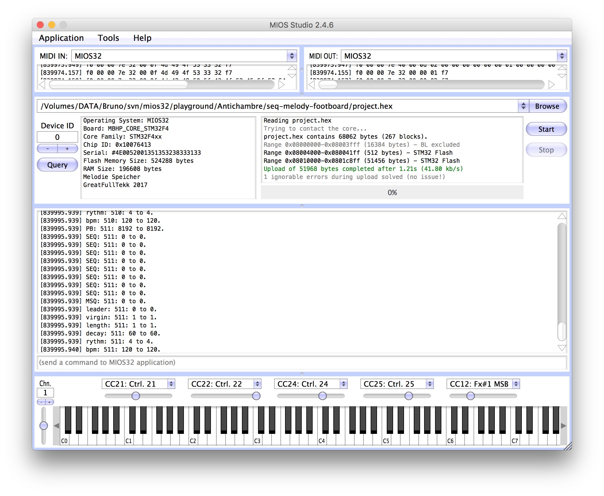

sorry I was on the way back home... But Peter was here.
This is what I propose you, I compile it successfully and call Edit function from App_Background without any Hardfault, I verify reset and copy subfunction by SendDebugMessage... All is fine.
your whole modified project: http://www.midibox.org/dokuwiki/lib/exe/fetch.php?media=phatline:seq-melody-footboard_copie.zip
in details:
first better to use same struct as clipboard:
//Card-Clip-Container
 store_t loop[8];
 store_t loop_copy;
//instead of
//  u16 SEQ_copy[512][8]  = {{}}; //Copy actual Track into ClipboardBuffer
//  u16 MSQ_copy[512]     = {}; //Copy actual Track into ClipboardBuffer
//  u16 PB_copy [512]     = {}; //Copy actual Track into ClipboardBuffer
//  u16 tact_info_copy[32] = {}; //Copy bpm, loop length, tact and so on
better using bits for edit flags, you will understand why after:
//  char edit[4] = {1,1,1,1}; //PB, SEQ, MSQ, Beatstructure,    Edit Flags for copy paste clear
u8 edit = 0xff; //PB, SEQ, MSQ, Beatstructure,    Edit Flags for copy paste clear
to initialise your tracks in APP_Init:
    //initalize 8 Tracks with standard values
    u8 a;
    edit= 0x0f;
    for ( a=0; a<8; a++ )Edit_Clip(a, 0, 0);
This is what I did to check edit function at startup:
void APP_Background(void){
#ifdef APP_EDIT_TEST
    edit= 0x0f;
    Edit_Clip(0, 0, 1);
    u16 c, x;
    for( c=0; c<512; c++ ) {
        MIOS32_MIDI_SendDebugMessage("PB: %d: %d to %d.", c, loop[0].PB[c] ,loop_copy.PB[c]);
        for(x=0; x<8; x++)MIOS32_MIDI_SendDebugMessage("SEQ: %d: %d to %d.", c, loop[0].SEQ[c][x] ,loop_copy.SEQ[c][x]);
        MIOS32_MIDI_SendDebugMessage("MSQ: %d: %d to %d.", c, loop[0].MSQ[c] ,loop_copy.MSQ[c]);
        MIOS32_MIDI_SendDebugMessage("leader: %d: %d to %d.", c, loop[0].leader,loop_copy.leader);
        MIOS32_MIDI_SendDebugMessage("virgin: %d: %d to %d.", c, loop[0].virgin,loop_copy.virgin);
        MIOS32_MIDI_SendDebugMessage("length: %d: %d to %d.", c, loop[0].length, loop_copy.length);
        MIOS32_MIDI_SendDebugMessage("decay: %d: %d to %d.", c, loop[0].decay, loop_copy.decay);
        MIOS32_MIDI_SendDebugMessage("rythm: %d: %d to %d.", c, loop[0].rythm, loop_copy.rythm);
        MIOS32_MIDI_SendDebugMessage("bpm: %d: %d to %d.", c, loop[0].bpm, loop_copy.bpm);
#endif
    // endless loop
    while( 1 ) {}
Result:
fetch.php?media=antichambre:capture_d_e_
Working with edit bits flags, You have to verify this cause I haven't got the necessary hardware.
