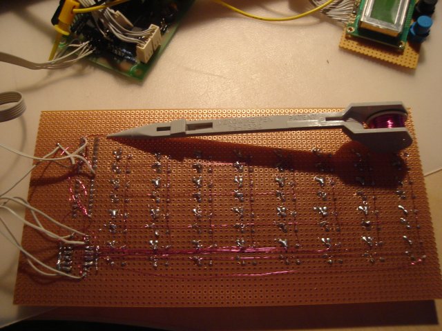

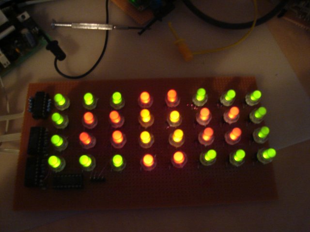

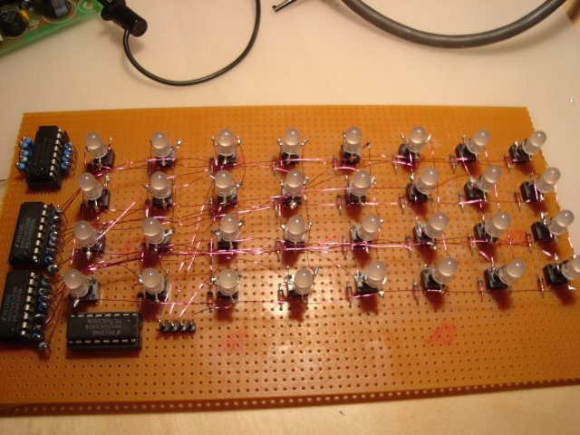

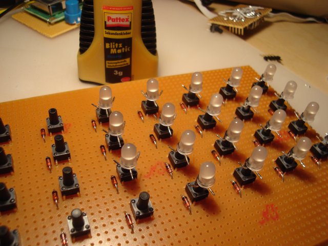

TK. Posted September 18, 2006 Posted September 18, 2006 Here my experiences: by using verowire the LED connections can be made flexible enough so that there is no danger that the legs get broken over lifetime.Verowire is expensive, but allows to wrap the connections between buttons, LEDs and shift registers quickly - compared to ribbon cable I used in previous projects, it only took 1/3 of the time to wire a complete board, since it was not required to deisolate the cables with a cutter - just heat up the isolation :)Creating the whole module took about 5 hours.Here some pictures:Bottom of the board with all the button connections to the shift registers - you can also see the "Verowire pen" I'm usingGlueing the LEDs on the buttons - they are sitting very solid; later they will be held by the frontpanel in addition...after I soldered the LED connections - it looks a little bit like tinsel over a christmas tree ;-)The module was working immediately :)I'm using Red/Green Duo-LEDs. When both LEDs are lit together, the resulting colour is yellow. So, I've three colours now :)Disadvantage of this technique: I will have to consider a certain tolerance for all button holes, since it is difficult to adjust the distance between the buttons; the LEDs are not sitting 100% aligned! However, I guess (or hope) that with the frontpanel these cannot be noticed anymoreBest Regards, Thorsten.
puddingbrumsel Posted September 19, 2006 Posted September 19, 2006 :o nice pics TK !! The verowire is isolated ?? looks more copper than anything else ;)What's that in german - verowire ?? didn't find something similar @reichelt. ??? How did you connect the leds to show the other color ?? are they connected to a DOUT ??mfg Christian

TK. Posted September 19, 2006 Posted September 19, 2006 What's that in german - verowire ??In german it is called "Fädeldraht"How did you connect the leds to show the other color ?? are they connected to a DOUT ??Buttons are connected to a 4x8 matrix, and LEDs to a 4x16 matrix. I've written a special driver which allows to control the red and green LED seperately.how tough is the insulation on that verowire? surely it'll rub through, won't it?No problem here, it takes some time to melt the insulation with a soldering irongood idea though! what's the board for?Together with a second board it will be an extension for MIDIbox SEQ.So, I will see some animated colour LEDs soon :)Best Regards, Thorsten.
