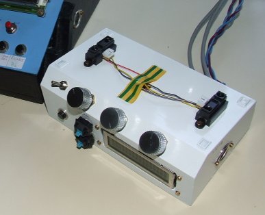

I finally finished my AC Sensorizer and it's working! (this is really incredible, since i used a protoboard and you should look at the mess on it!)
now it's time for some questions...
1) i cannot handle the use of the control CC64 as a pedal. i want to use the sustain pedal of my masterkeyboard as the pedal of the ACSens. but for me it donesnt work (or i didnt understood how to make it work)
i think the ACSens. is receiving MIDI, since if in MIDIOX i send the sysex string
F0 00 00 7E 40 00 01 F7
i immediately receive a series of F0 00 00 7E 40 00 0E 0C 00 F7 as "answer", so midi is sent and received.
is there any other way to test midi input?
i cannot understand how to use control changes to control the AC sens. (via CC98,99...etc) , neither use CC 64 as pedal, or use the external pedal to trigger autosense max/min
do i miss something?
2) i didnt measured the output of my distance sensor GP2D12. my question is: did you ever tried to amplify a little the signal with an OP amp like the LM324? i connected my pressure sensor and, since it outpou was really low (i think 0.3 V max) i succesfully managed to use a ~10 gain to have a better output. moreover, i had to use a "bridge amplifier" (see LM324 schematics) to hook the sensor outs.
this is because the sensors seems not so stable... can the gain of the LM324 be better of the PIC's one?
3) regarding distance sensors, which setting are you using and which sense values work best for you? did you built something to "cover" the sides of the sensors? mine are just fixed at the top of the box, and they are completely "naked" in the air...
4) if i play notes and set up a scale (for ex. C MAJ), and i change the root key (D MAJ) nothing seems to happen
anyway, after an entire afternoon of soldering and a night of rest, i'm still quite exhaust... but  i look forward to play with the new toy! :-)
thank you! :-)
PS: i have to admit i don't have the standard 6n138 as optocoupler, but an equivalend one named HCPL 2730 which has two inputs, but i think the wiring is correct (different from 6n138 one)... moreover sysex seems to be received....
unfortunately i cannot find the 6n138 here... :(
PPS: i'm using ACsens ver. 0.4.4
additional edit: during buildup stage i uploaded MIOS code using another midibox. in order to avoid complication and to proceed with work without excessive debug  but even if now sysex are displayed in MIDIOX when i do the "ping" using this optocoupler, i cannot upload mios code in this core using midibox studio. i receive the message "MIDI IN FRAME ERROR"

Posted
thanks for the reply!
for now, i have the complete thing working
including the breath controller!
you may wonder why i have only three encoders... it's because i had only three left spare at home and i cannot buy them in my city (that one came from the midibox 16e order!)... so instead of ordering just one encoder from VOTI i preferred this solution...
i used a two-pole deviator in order to "double" one encoder to two! :D i use only one encoder + the deviator for sensor select and menu navigation. it's quite easy also in this way!
the only thing that gives me problem now is the midi IN... and i don't undestand if it's the optocoupler or the circuit design...
i hope to find info... my last resort would be to buy some optocoupler from another midiboxer... ;)
i have only three button since i planned to use the external CC64 as pedal... the third button is "panic" and now i'm desoldering it to use it as a pedal one.
do you fell "panic" is useful? (sorry, i didnt tested the car on the road, yet :D
the last thing will be to add a softpot XY!
as i said in another thread.... the only matter here is how to connect that damn plastic connector to a wire!!!  ???
thanks for your help (and for the project! ;))

Posted
now that i solved the midi-in matter, everything is OK!!  ;D
i even understood how to use NRPN events!

why it does flicker??
i built a ribbon controller, and it behaves good, but it flicker with an high range when i don't touch it (so when it should be at minimum value).
look at my project here:
http://www.alchemystudio.it/Strumenti/ACSensorizer/ACSensorizer_en.html
if i don't touch the wire (so the "circuit is open") and i measure the voltage, it reads 0.35 V and it's pretty stable. it maybe reads +/- 0.01 V
but on the ACSensorizer, when i use autosense, the values read flicker in the 0-70 range (out of 255 scale), very fastly
if i touch the the ribbon, the voltage remains stable as before, and the ACSensorizer values become stable, and the minimum value that i can achieve is around 35.
of course i could set the minimum value to 80 or 90, but i'd lose a significant part of the ribbon...
what should be the reason of this flickering at minimum values on the ACSEnsorizer??
i tried to change PIC AIN channel, but nothing happens.
and why the voltage read seems stable and the acsensorizer input is not?
beside this, the two distance sensors doesnt show this problem.
an idea i had: if i short circuit one of the two side of the guitar string  with the tape, i would obtain a definite and fixed value (for example the minimum) when i dont touch the string.
but, even if this is working and i could use the "release detect" function, this changes the behaviour of the ribbon from linear to something logaritmic (or parabolic or so on...),
so it's not so usable... you have for example the first half of the ribbon which changes from 1 to 30 (in MIDI CC steps) and the other half from 31 to 127 (and if you consider the half of this half the behaviour is practically the same!)... so this is not option i would like to consider...

yes!
i solved the flickering problem!!
preamble:
i checked now with a tester and between ground and the string wire (signal) at rest (so when the string is not touched) i read 0.21V.
i added a diode with threshold voltage of about  0.15V (i had it a home, i was lucky). the diode reads: 1N5180 between ground and signal.
in this way flickering was reduce but not deleted.
then i had the idea of adding a small cap. it was a cap spared from the sid filter or from the midibox power supply i think, so it should be in the 1-100 nF range, i don't know...
anyway, by doing these two operations, the flickering was totally eliminated!! :-)
edit: i feel the diode is completely useless... but now since it's not broken i will not fix it!! :-)

Hi,
hehe... it's good to see that some things solve themselve ;D
I was away, so I just read your postings. Indeed, I would have suggested a small cap as well, so that the signal is grounded if you don't touch it. If it's not grounded (floating) there are some random values like as you would expect from an unconnected AIN pin. This behaviour is related to the MBHP Hardware concept and not specific to the ACSensorizer program.
Best,
Michael
