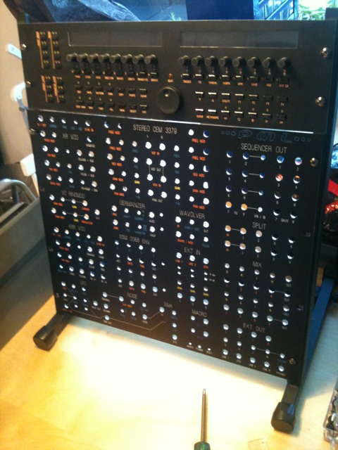

Just testing racking the monster.
Science!
Thanks! She needs populating first
But, it will all be good, goofy, gooey fun in the end. Design freeze was 111009, aiming at working like mad to have it up and running by 111111 one one eleven!!!!
2xVCOs (Thomas Henry - one 566, one XR2206), a dual/stereo CEM3379 VCF (PML), dual envelopes (PML), ring mod (Fonik), SN76477 noise and S/H (TH and Fonik), Ian Fritz Wavolver waveshaper on our own PCB, Germanizer germanium diode distortion (PML) and MB-seq w/ 8channels of CV/Gate (TK's genious sauce and design - Wilba stylee CS, Fussylizard arranged the order, Julian F did the panel, we did the CV/Gate out PCB).
This is PML stylee (that's me and my pal FS) - we mix the borrowed (TK, Thomas Henry, Fonik, Ian Fritz) with our own custom sauce. Next time we eat the future!
