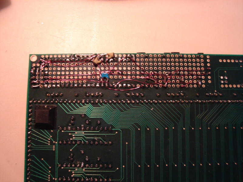

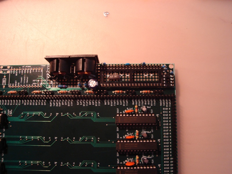

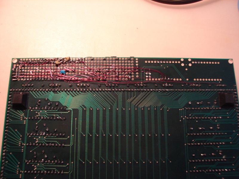

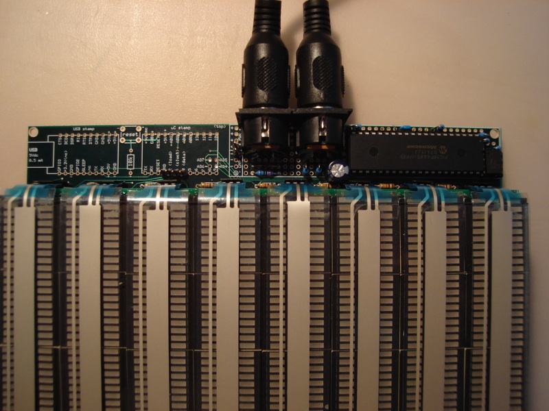

I quickly hacked a MIDIbox based firmware for the Stribe project, and already had a lot of fun with it in conjunction with Reaktor.
YouTube video
The released firmware is available in the MIOS download section
Temporary updates can be found in the Repository
Reduced MBHP_CORE circuit for Stribe board (can be soldered on the prototyping area). The Arduino modules are not required for this solution.

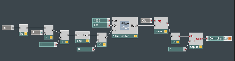

Yes, the meters are much better, because with Reaktor I was able to construct my own "algorithm" :)
It basically consists of a rectifier, amplifier, lin/log-converter, slew limiter (to smooth the waveform), sample&hold stage, step filter (events are only forwarded if there is a difference of >= 1) and CC output unit:
Posted Image

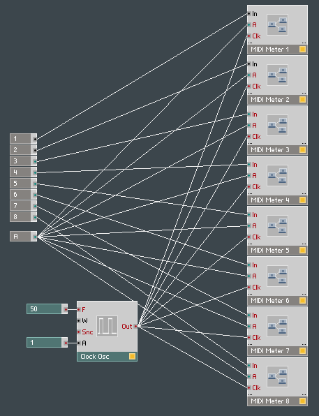

8 of these macros are stacked together, and the S&H stages are clocked at 50 Hz to reduce MIDI traffic:
Posted Image
It looks simple, no? :)
