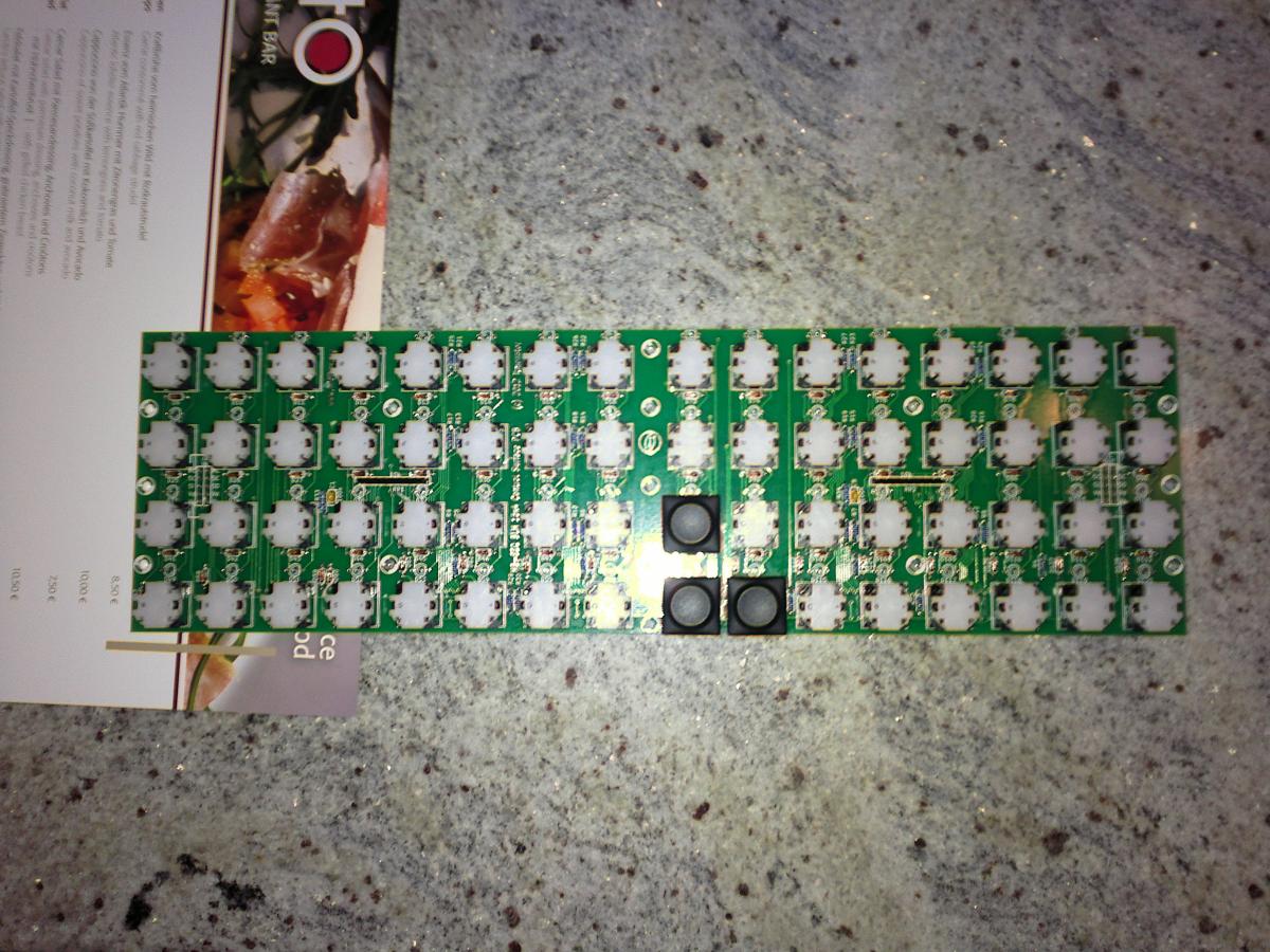

freddy Posted February 15, 2013 Posted February 15, 2013 ilmenator - no kidding, I told you about the source and the price before (PM on 7/1) though without the links :sad: orange - while browsing PMs with ilmenator I found some poor quality pics of the 19mm caps, attaching them as a teaser before I'll make proper pictures the following weekend. Basically, to get an idea, using 16mm caps (the smaller and more expensive at Conrad) this leaves ~4,5mm space between the buttons as can be seen on ilmenator's Wiki page, using 19mm this leaves ~1.5mm for the panel width.

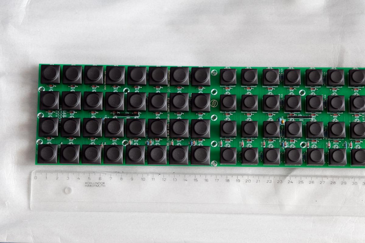

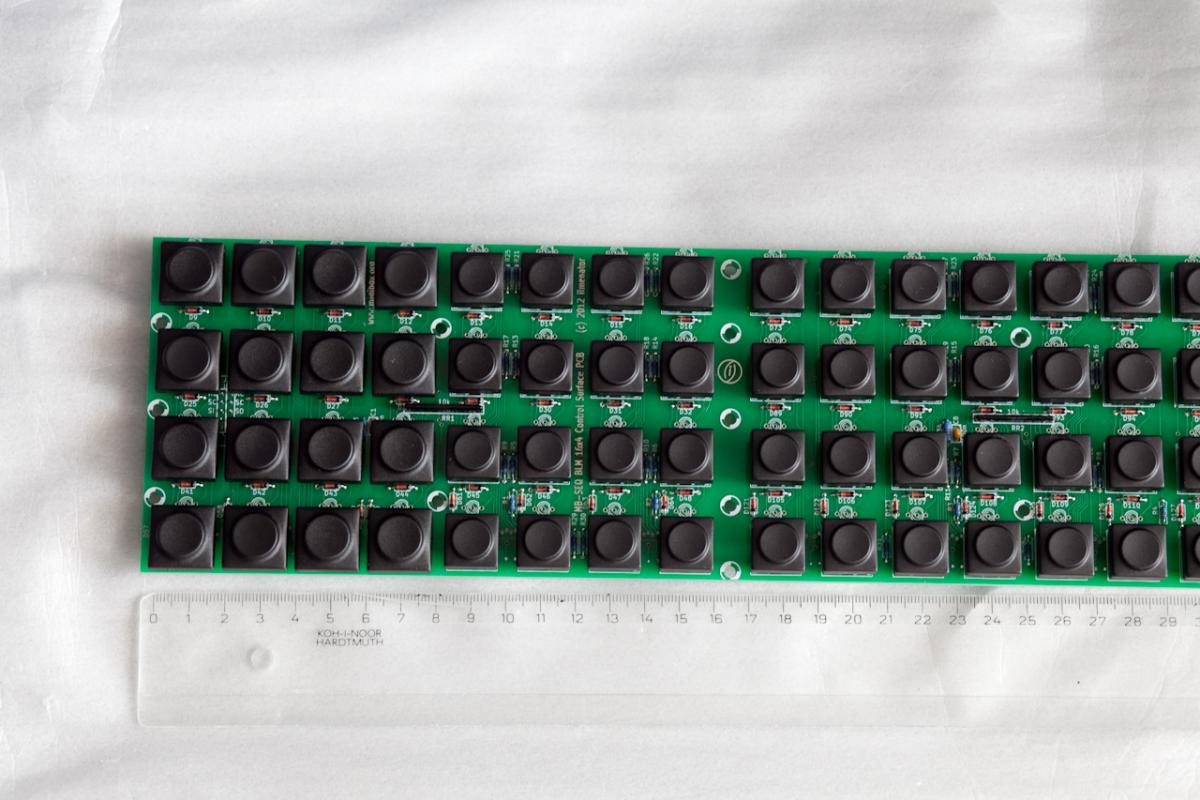

freddy Posted February 23, 2013 Posted February 23, 2013 (edited) Hi Freddy, I can wait ..... Orange, Here it is, the images are self-explaining, if you want to take picture from another side, angle, or caps combination, let me know, I'll have the camera around me till Sunday, flying back to Frankfurt on Monday. Edit: I just realized that the 19mm caps will be covering the LEDs so the LEDs would need to bended a bit (by app 1.5mm) to the top. There is still enough place to fit a 3mm LED between the rows, though. Edited February 23, 2013 by freddy
