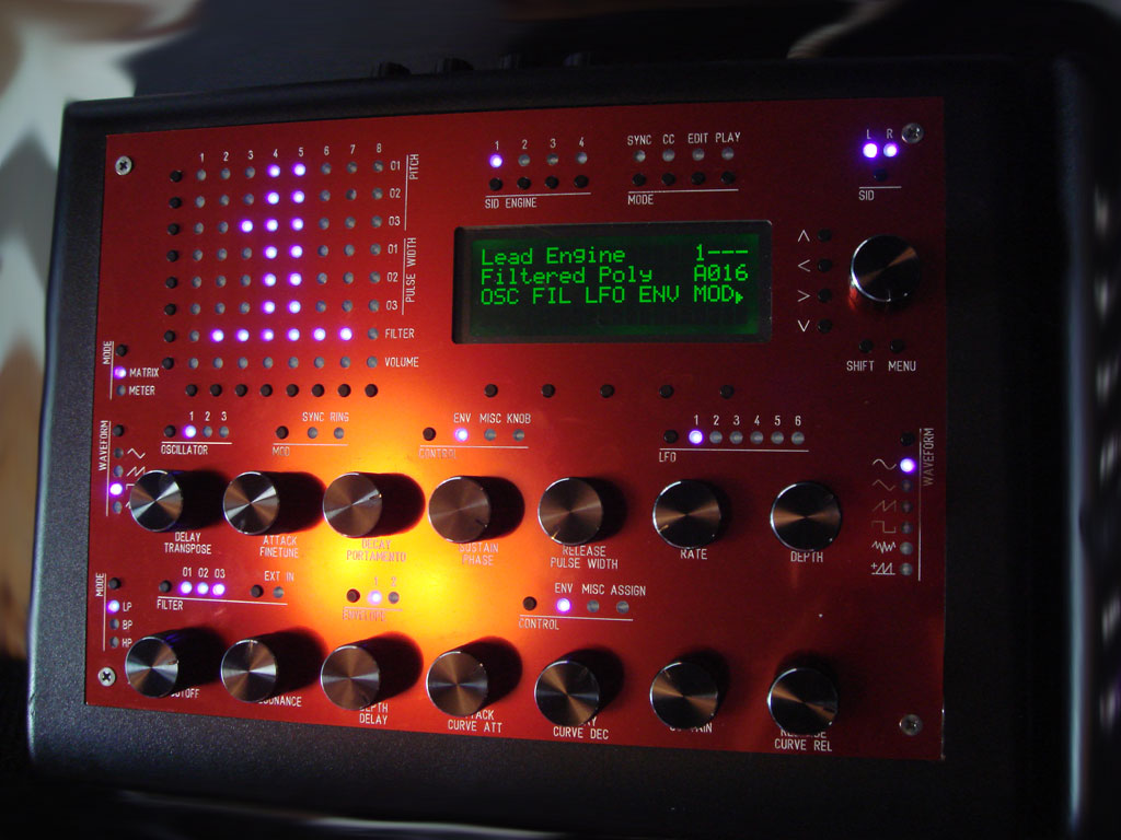

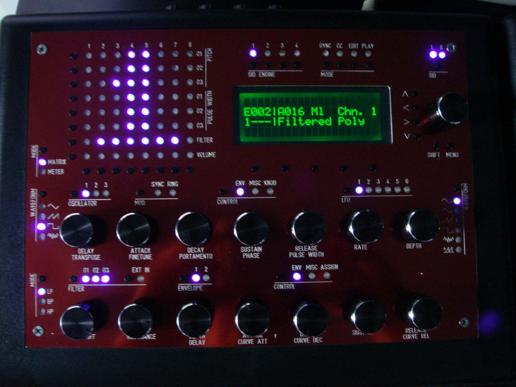

iZZE Posted November 3, 2010 Author Posted November 3, 2010 (edited) Niiiice! I'm jealous of your color scheme! Thanks Pingosimon.. my Cam doesnt capture the colours right (the colour is nicer actually) because its difficult to photograph UV LEDs but you get the idea. I am very happy, i never thought that i would finish the MB-6582 so fast. Its fun to play around with, but a lot to learn till i can actually start making full tracks with it. It is funny..... when i walked outside my apartment to get something to eat, i never used to lock the door before.. since i got the MB-6582 i always lock everything up properly to get sure nobody takes it away from me :ahappy: Edited November 3, 2010 by iZZE

rvooh Posted November 5, 2010 Posted November 5, 2010 very nice but i think those UV leds are dangerous, sanded or not.
iZZE Posted November 5, 2010 Author Posted November 5, 2010 They are emitting UVA which is used for Blacklight, which isnt dangerous.. Safety first heh ? :thumbsup:
