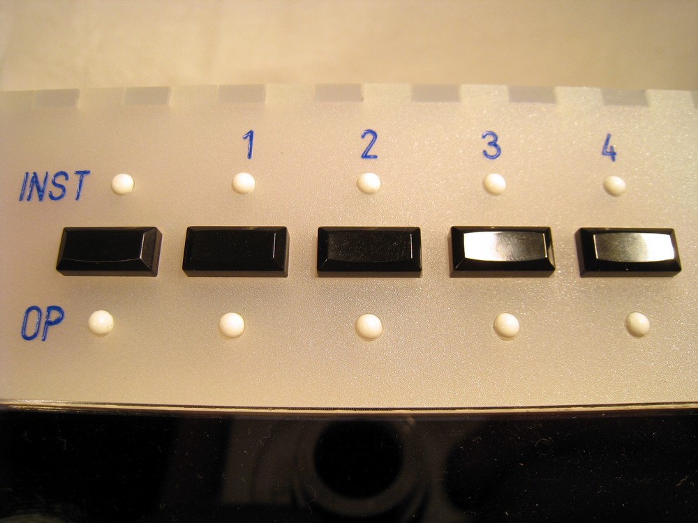

Wilba Posted May 3, 2011 Posted May 3, 2011 OMFG that Optrex LCD looks filth. Great choice of paint colour. The LEDs rock... they look totally opaque and glossy when off, might be just the flash though.
Siempre La Luna Posted May 3, 2011 Author Posted May 3, 2011 The Optrex LCD is really impressive. The color is really rich and the black is quite dark. The LEDs are indeed opaque white. I'm always on the lookout for low brightness blue LEDs and I bought these under the impression that they were not at all bright. After I received them, I breadboarded a couple and and promptly learned that they were not at all low brightness. In fact, they were some of the brightest 3mm blue LEDs I've ever seen. In the end I decided to paint the tops of the LEDs white. I dipped them in some white enamel just to cover the domed part that covers protrudes from the sammich case. It really cuts the brightness while allowing the unpainted portion of the LED to illuminate the translucent panel around the LED. I'm really pleased with the way it turned out. The effect is really cool. I tried a few different colors of enamel to see how the effect differed. Black was too dark, blue looked uneven in the presence of varying paint thickness, but white was consistently great. This sammichFM is for my girlfriend so it was important to me that it look as good as it sounds She saw it last night and totally loved it.
Siempre La Luna Posted May 4, 2011 Author Posted May 4, 2011 Painted LEDs! I think you just started something big. I think so. It looks great and it's easy to do. I've got a gnarly week at work coming up, but I hope to get a chance to mess around with the idea a little more and see if I can come up with anything super cool. Perhaps it's time to change the title of this topic to 'sammich behaving awesomely'
kristal= Posted May 5, 2011 Posted May 5, 2011 (edited) @Siempre La Luna: I really like your design and already voted 5 stars for it :smile:. May I ask you for the LED brightness? I would like to use white-painted red-glowing LEDs in my sammichFM design, but I'm not sure how bright they should be. I consider using 100mcd ones. Best Martin Edited May 5, 2011 by kristal=
Siempre La Luna Posted May 5, 2011 Author Posted May 5, 2011 @Siempre La Luna: I really like your design and already voted 5 stars for it :smile:. May I ask you for the LED brightness? I would like to use white-painted red-glowing LEDs in my sammichFM design, but I'm not sure how bright they should be. I consider using 100mcd ones. Best Martin I'm glad you like it. The blue ones I used were 200mcd. Blue and white LEDs are way brighter than most red, green, or yellow LEDs so you might want something a bit brighter. I'm no expert though, so it's probably best to try a few different ones and see which gets the best results. Be sure to let us all know how it turns out. :)
kristal= Posted May 5, 2011 Posted May 5, 2011 (edited) @Siempre La Luna: Good to hear! If your LEDs are 200mcd bright I sure will be fine with 100mcd. I plan to keep it eye-friendly since 25mcd are bright enough for me, so no need for the 2000mcd ones from Hong Kong :pinch: Thanks for the advice & inspiration and I will keep you updated on how this idea turns out.:smile: Probably in the beginning of June I will have the sammichFM readily assembled. Edited May 5, 2011 by kristal=

fussylizard Posted May 29, 2011 Posted May 29, 2011 FWIW I recently finished a sammichFM that followed Siempre's color scheme. I tried 3 different LEDs using the stock 220 resistor. One (Mouser 604-W934MBDK) had 25 mcd brightness and was perfect (I don't like super-bright LEDs). The other two were 700 mcd (Mouser 593-VAOL-3LSBY1) and 190 mcd (Mouser 859-LTL1CHCBK - end of life part so not recommended). The latter two were much too bright so I tried Siempre's painted-LED trick and it worked great. I just dipped each one right into the paint about 3-4 mm. The brightness was good with a single coat. In the end I went with the un-painted version since is was the most straightforward and I was worried the paint would make the LED too big for the hole. So now the important question: do I still get to call my color scheme (arctic white case + blue LCD/LED) the "Siempre de la Luna Edition" without painted LEDs? :-) Regards, C
Siempre La Luna Posted May 29, 2011 Author Posted May 29, 2011 (edited) FWIW I recently finished a sammichFM that followed Siempre's color scheme. I tried 3 different LEDs using the stock 220 resistor. One (Mouser 604-W934MBDK) had 25 mcd brightness and was perfect (I don't like super-bright LEDs). The other two were 700 mcd (Mouser 593-VAOL-3LSBY1) and 190 mcd (Mouser 859-LTL1CHCBK - end of life part so not recommended). The latter two were much too bright so I tried Siempre's painted-LED trick and it worked great. I just dipped each one right into the paint about 3-4 mm. The brightness was good with a single coat. In the end I went with the un-painted version since is was the most straightforward and I was worried the paint would make the LED too big for the hole. So now the important question: do I still get to call my color scheme (arctic white case + blue LCD/LED) the "Siempre de la Luna Edition" without painted LEDs? :-) Regards, C LOL. The Siempre La Luna Edition, awesome. It certainly has a nice ring to it. I like the look of it so much that I went back and blanked the LEDs on my sammichSID too. I hate to say it though, I think the blanked-out LEDs are the crucial bit of the SLL edition. Edited May 29, 2011 by Siempre La Luna
