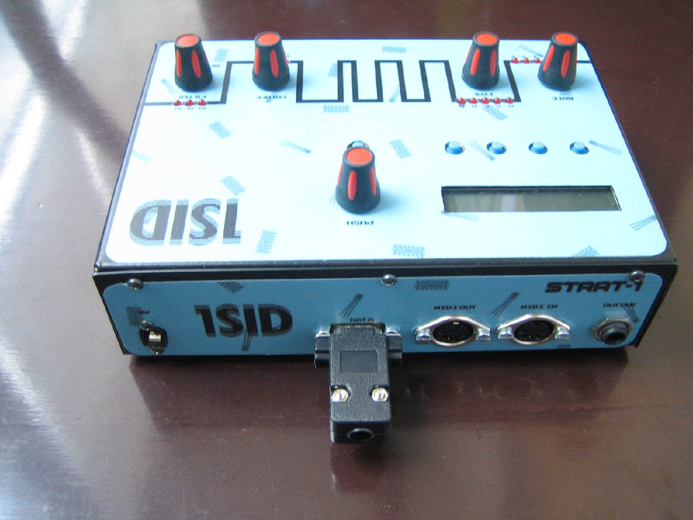

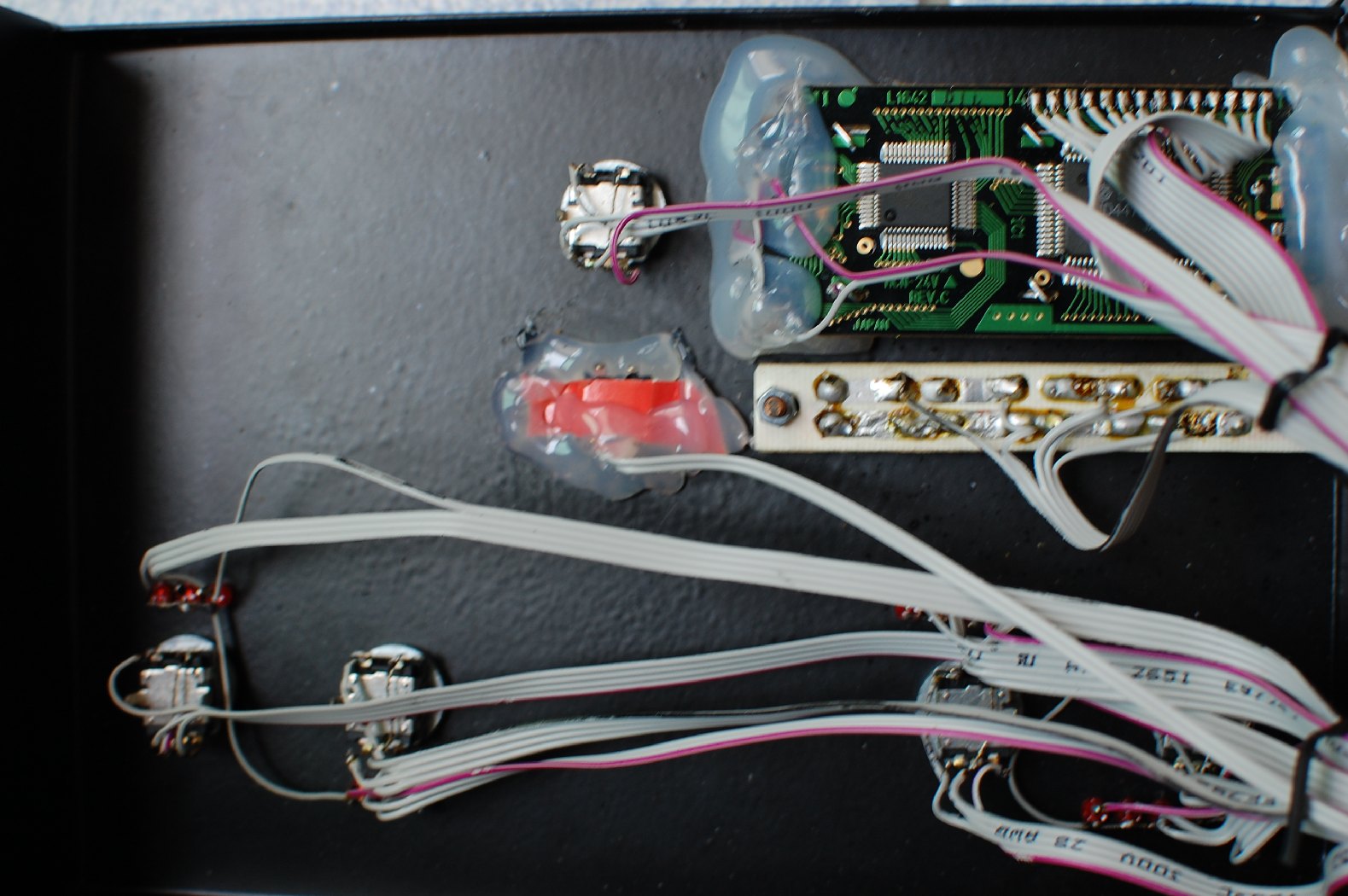

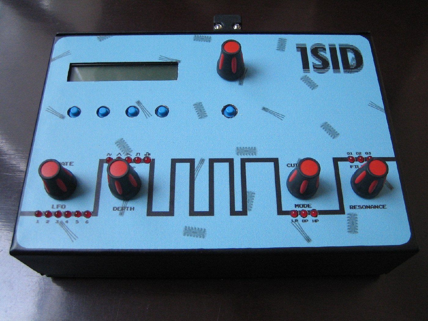

Midibox SID was one of my first projects, i built it 4 years ago. I was a beginner, all the wiring looks horror for me now.

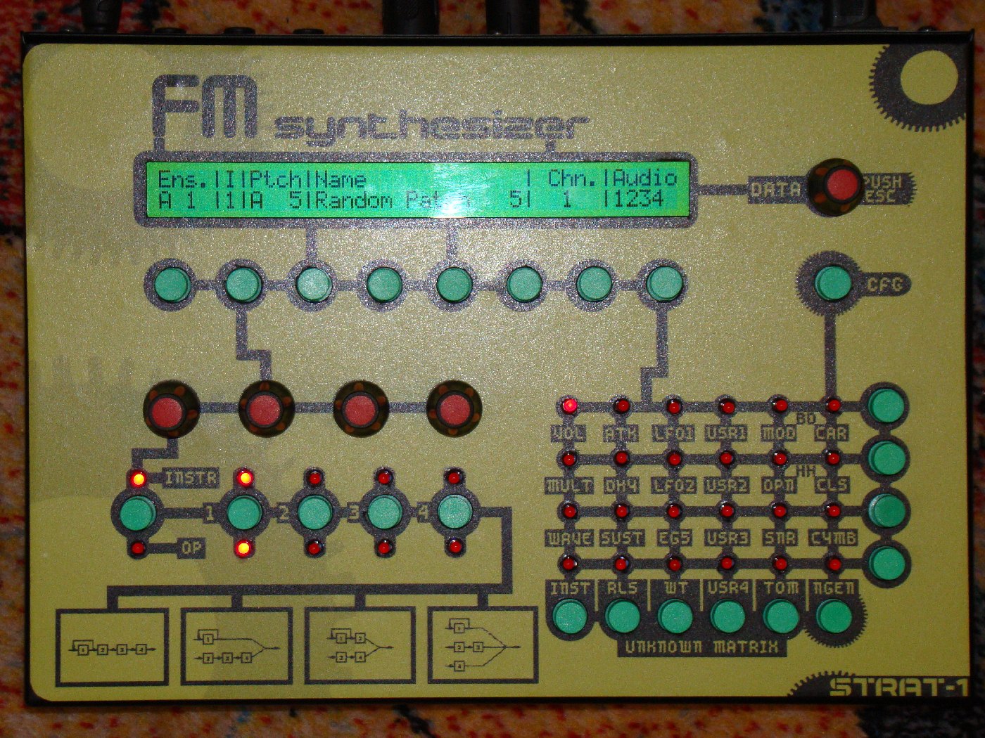

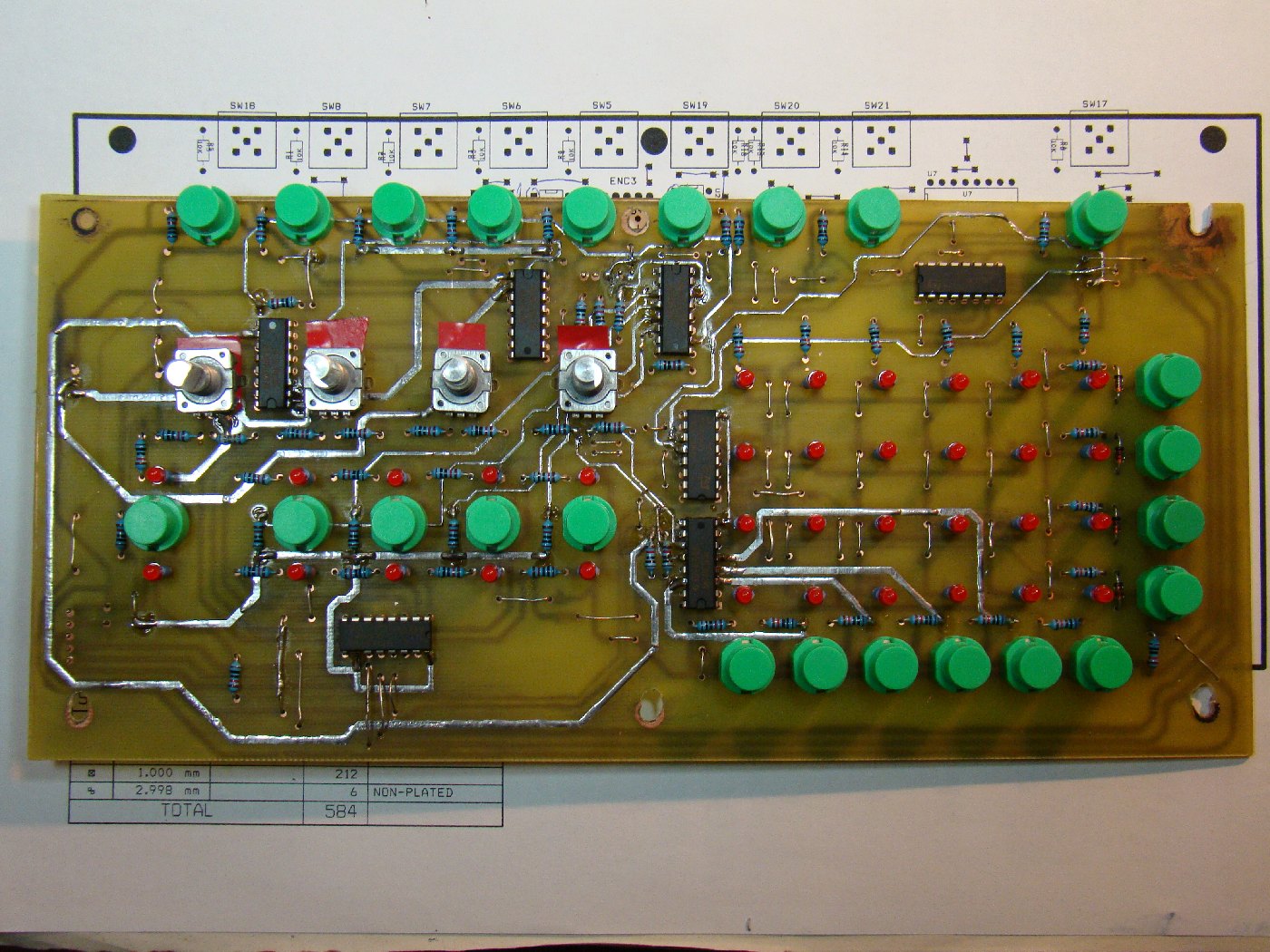

In time I learned Orcad and I built Midibox FM redisigning in my way the PCB. (built 1 year ago)
The boxes are made with Autocad. And the prints are on printed sticker.

Agreed ... MBFM is lovely. I like the look of the SID too!
Did you etch that double-sided board yourself?? That's always a challenge!

the fm has a cool design. it somehow reminded me a bit of the old eighties computer game graphic style!
well done!

I etched that board myself. I used vias from one face to another.
It's not so hard. First I print the front face with fewer layers, using press and peel.
Second I make the drills. And after that I print the bottom layer using the holes that I made as a guide.
