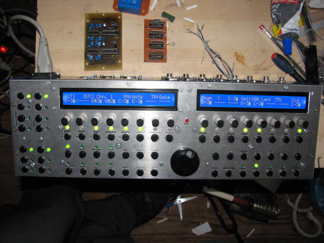

tashikoma Posted August 26, 2011 Posted August 26, 2011 thanks to TK and the community handmade aluminium frontpanel with standard cheap drill!!!! not perfect but works DIN and DOUT with a lot of wiring , duo GP leds ... lot of work !!! the Wilba CS is a better solution! seq V4 is amazing.... whaouh!!!!! next step is installation of the aout and the four midi IIC options......
stuartm Posted August 26, 2011 Posted August 26, 2011 Well done! Looks very sturdy and "made-for-the-field" ! Enjoy making music with this wonderful machine !
rosch Posted August 26, 2011 Posted August 26, 2011 (edited) looks like a very decent job to me! it looks flat, is there room inside for more boards (or are you going to add a breakout box)? did you use on board transformer? quite obviously Edited August 26, 2011 by rosch
tashikoma Posted August 26, 2011 Author Posted August 26, 2011 thanks!!! :rolleyes: there's just enough place for all the boards!!!!! there two transformer : 2x9v(2x2A) and 2x15v(2x100mA). DOUT , standard LEDs and DIN are powered by another 7805 because the 7805 from the core was too hot!!!! the second 5V power could drive a BLM with low current leds!!!! rear panel is metal from the back of an old cd player.... the rest of the box is plywood!!!! it's time learning use it!!!!! :thumbsup:

tashikoma Posted August 27, 2011 Author Posted August 27, 2011 Merci Julien! after use the seq ... it's a very good machine lot of possibilities lot of good fonctions.... great the only thing that i don't understand is the mixer section in event you can choose the port and the channel but not program change i don't understand how to assign program change per track. is it possible?
TK. Posted August 27, 2011 Posted August 27, 2011 Great build!!! :) i don't understand how to assign program change per track. is it possible? yes, by using song phrases. See also this posting: I added a third example where a mixer map, mutes and tempo is set Best Regards, Thorsten.
tashikoma Posted August 27, 2011 Author Posted August 27, 2011 Great build!!! :) thanks Thorsten!! :sorcerer: (nice to have a comment from the genius god of uccaps! :thumbsup: ) I've understand now the song mode it's exactly what i was searching! how to assign mixer map! yeah!!!
