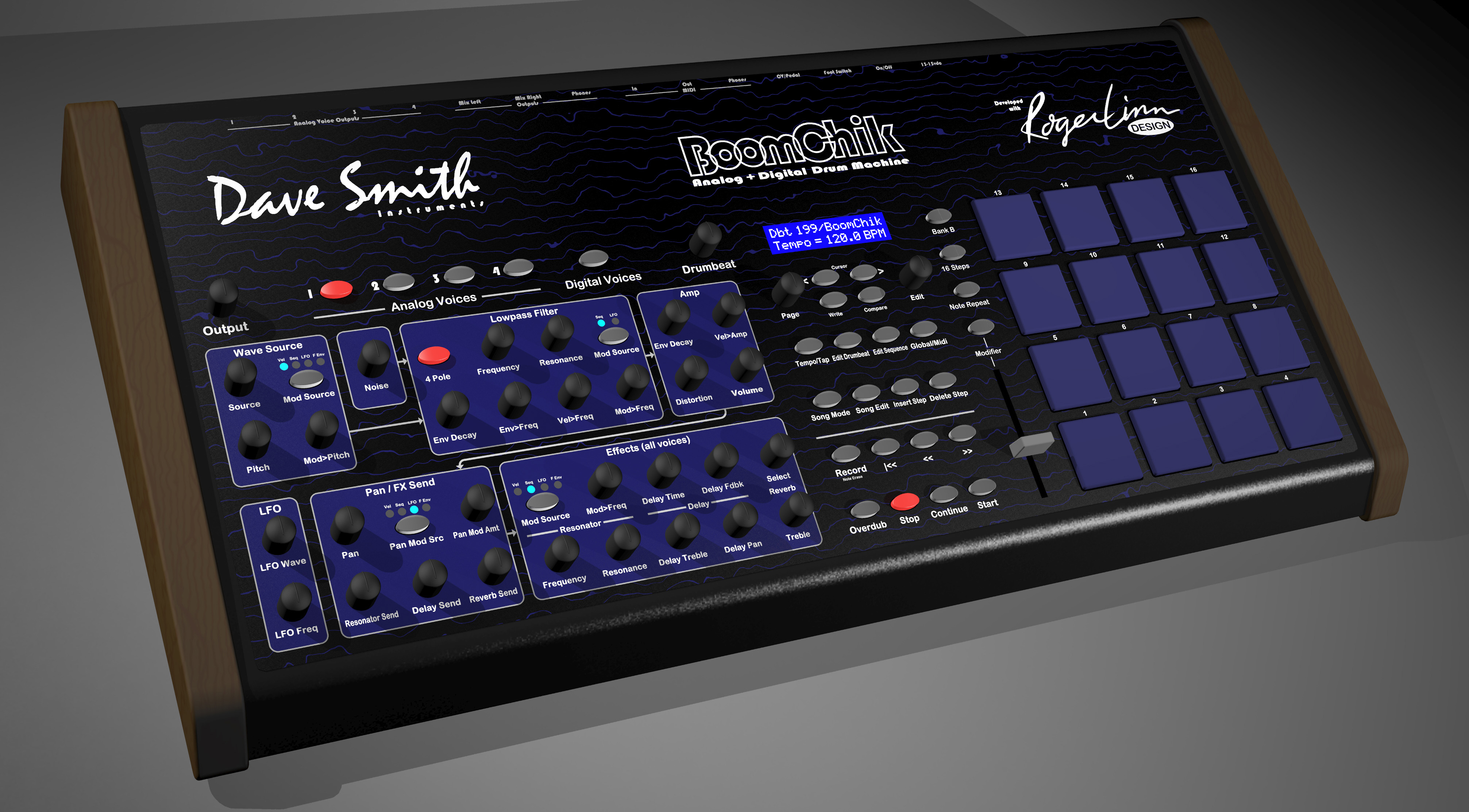

Zippy Kid Posted December 4, 2011 Report Posted December 4, 2011 (edited) How to create drum pad midi controller?I want to build or ask other for money build midi drum pad controller in metal enclosure look like Korg nanopad, or like BoomChick (only midi) or like Vestax Pad one.. Please help... with Dynamic trigger pads that will capture all my performance nuances I need 9 or 12 velocity-sensitive pads provide excellent response to my fingertips, and also realistically convey the playing feel to my sequencer or DAW software, ensuring that my drum parts will be full of life. By switching between the them , I want to experience more different pad assignments. Edited December 4, 2011 by Zippy Kid Quote
