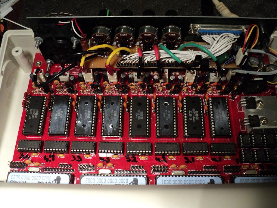

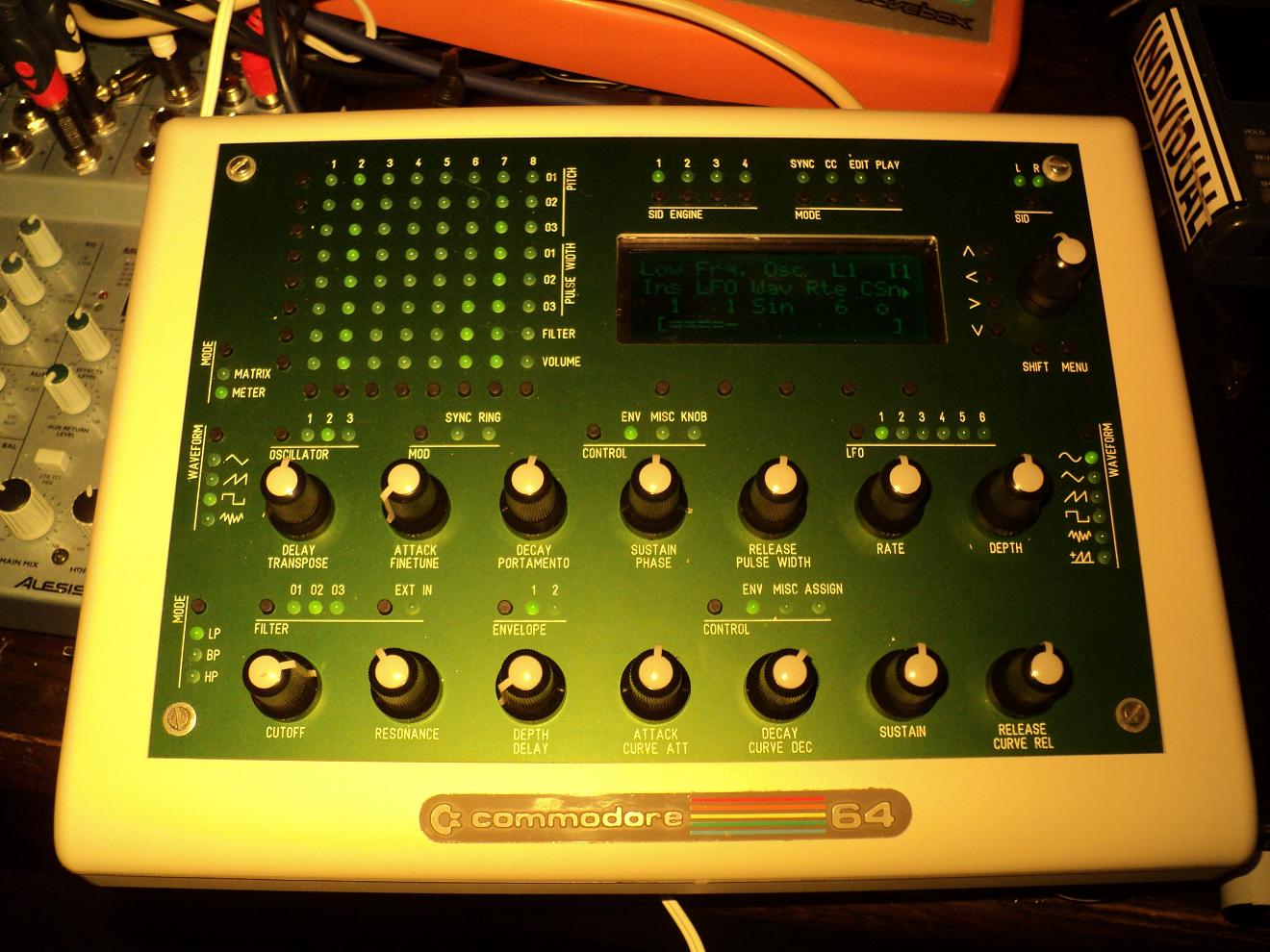

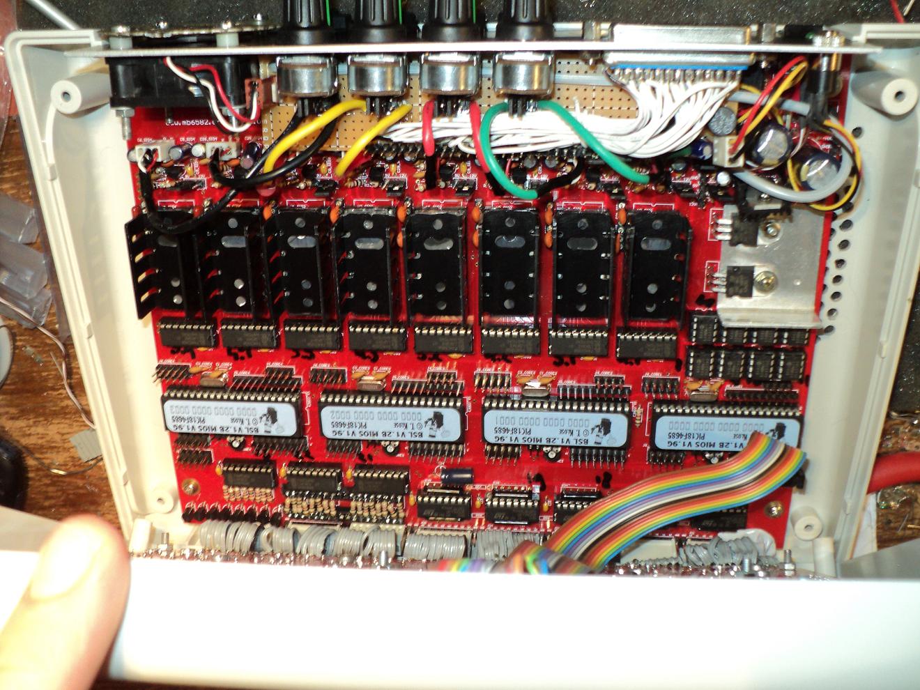

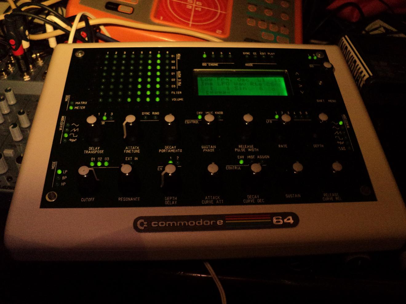

X11 Posted December 11, 2011 Posted December 11, 2011 Hi everyone, Here some photos of my new toy. I want to thank u all for for sharing information. Tk,Tim and Wilba thanks for the pro work!! I geuss im getting addicted to midibox :yes: Peace! Hans
X11 Posted December 11, 2011 Author Posted December 11, 2011 The panels are from Julianf (recommended) Sids from c64 doners:) Used the 5v6 zener/triac crowbar to avoid horror. lovely lcd from poland(ebay) Next to do is taking the fan out off the 5v line, add an 7805 for it on the extra perfboard and feeding it with dc from before the rectifier. trying to figure out the options for the external connector (ssm2044 or something like that) and add different knobs because these ones are not mine:) and ofcourse make some music with it!! :heart:
Elektruck Posted December 12, 2011 Posted December 12, 2011 (edited) Dear Hans, I think your LED's are a bit bright, and too yelowish! Edited December 12, 2011 by nILS please don't fullquote
Shuriken Posted December 12, 2011 Posted December 12, 2011 Dear Hans, I think your LED's are a bit bright, and too yelowish! Tbh, it may just seem that way. His picture is quite dark. And the leds don't look overly bright to me.

X11 Posted December 12, 2011 Author Posted December 12, 2011 :) thnx everyone @elektruck :hehe been fixed the day after it gave u welder's conjunctivitis ;) also replaced the sync led thinking it was broken,after some reading i guess it doesn't light up in the firmware right? :) peace!
Smithy Posted December 12, 2011 Posted December 12, 2011 (edited) Dear Hans, I think your LED's are a bit bright, and too yelowish! A picture from a digital camera is never truly representative of LED brightness or colour. Can I haz edit 4 "full quoting" 2 plz? /rolleyes Edited December 13, 2011 by nILS You can haz trout slap.
X11 Posted December 12, 2011 Author Posted December 12, 2011 Dear Hans, I think your LED's are a bit bright, and too yelowish! for the record : These are my own words when elektruck was present and helping me with the firmware upload, Luckily i had socketed the led resistors and went for the 1k instead of 220 ohms. So now next time elektruck visits me he can take off his sunglasses. Some warmth for elektruck since the :baby: forces him to move his studio to a cold shed. ;)
