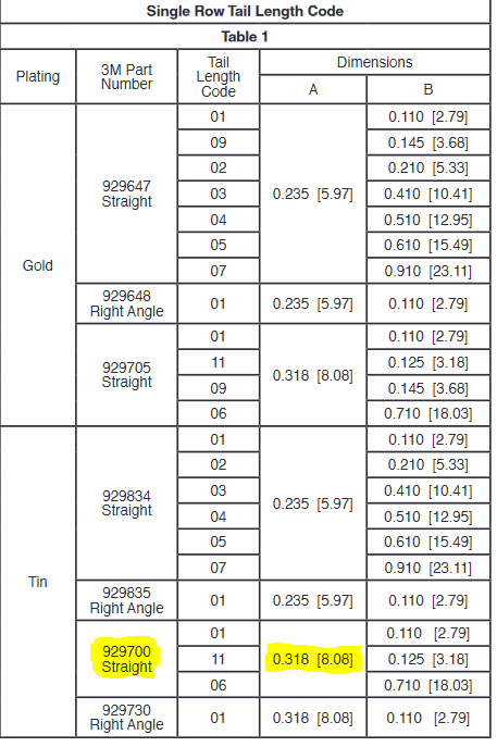

So the length of the "mating pin" / Dimension "B" is actually 6.8mm? I thought from original 3M datasheet it was 8.08mm / 0.318" freedom units ;) based on the codes: Dimension A in the original 3M datasheet btw. I have standard headers which are 6MM long on top btw.

Haha not 3 on top of each other no! I'm short 2 components from the BOM, they may have not been finalized when I orderered back in the stone age as Peter would say! ;) I'm short the 4816P-1-103LF Resistor network for RN5 on the LE MEC RH PCB so I presume its needed? Also i'm missing 929700-01-36-RK - the longer Pin headers. I believe these need to be about 8mm long from the top of the plastic to the top of the Pin itself (when standing upright). I think I've found some equivalents on RS, could you double check Andy if you dont mind? https://ie.rs-online.com/web/p/pcb-headers/6812310/ I'm going by dimension "B" in the datasheet: https://docs.rs-online.com/36e1/0900766b8135fed6.pdf
