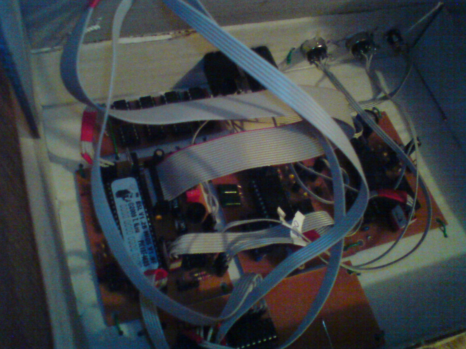

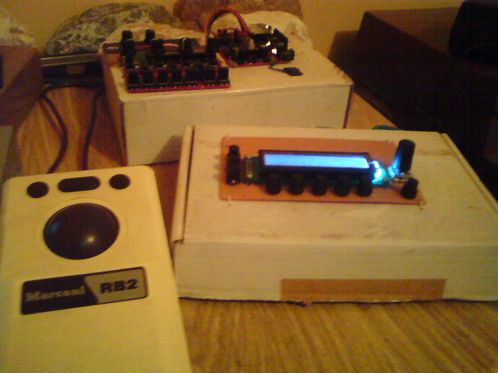

  18. years go by (literally) but now i've almost finished my 1st midibox Sid V2! it's a step B minimal stereo 8580 setup with 8x BankStick. i just temporarily put it in a cardboard box. it's running, but i still have to figure out some minor stuff, like changing the encoder settings. atm it's going 4 steps per move. at this point i'd like to thank you guys who have helped me, especially TK, Wilba, stryd_one, SmashTV, Mike! i'll update this as soon as i have made a cool case (soon to come)!  YAY! edit: typos, of course
