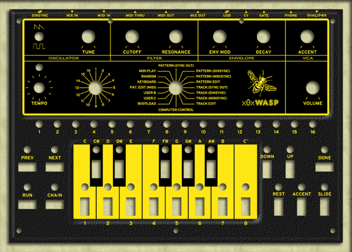

Goblinz Posted April 15, 2008 Posted April 15, 2008 Hmnnnn,, think I've found the panel for my second x0x... I'm building two; one with the rotated buttons and mods, using Sashas boards and a stock one using a board from ladyada... Somebodies designed some WASP type panels and there's an order going on at the moment..Order is here http://forums.ladyada.net/viewtopic.php?t=5544 Obviously these wouldn't go with Sasha's modified PCB's though I've wanted a Wasp for a while... Simply because it looks cool, at $50 a panel it's a bit pricey tho. Does anyone know if it's possible to get the button caps in yellow? G
Smithy Posted April 15, 2008 Posted April 15, 2008 Haha thats cool!wasps design is so retro looking, i love the idea of a pic of a wasp on a synth!
