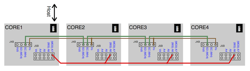

novski Posted March 1, 2013 Report Posted March 1, 2013 (edited) I asked this question in december 2012 it can be found here: And was further discussed in this Topic: Main advantage was to have a Display for each Fader/Channel. But in the mean time TK and Duggle implemented a way to hook up 64 Displays to one Core. You can Read about that here: The schematic about the connection between multiple Cores is to find here: http://www.ucapps.de/midibox_ng/multicore_interconnections.png But i don't think anybody ever really tried this exept maybe TK. How many Faders do you need? Best Regards novski Edited March 1, 2013 by novski Quote
