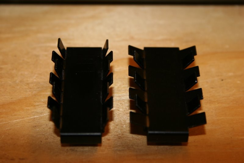

The first pic shows the unbent heatsink on the right, and the bent one on the left.  I only had to bend every-other fin.  You can see the white-ish crack lines at the base of each fin I bent.

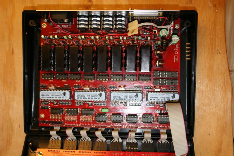

The third pic shows all 8 heatsinks installed on the MB-6582 base board.  It's a tight fit even after bending the fins, but it all fits after bending the fins.
