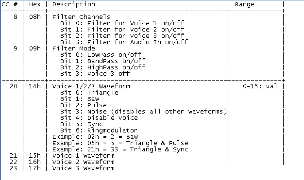

Maybe I'm just being dense, but could somebody explain these sections of the CC implementation chart to me in plain English? It would help me greatly, thanks. (I attached the sections of the CC chart as an image to retain the formatting)
Which part don't you understand???
I assume the bit0/bit1 etc stuff?
This just means that for these CCs, the value that you send is made up of various 'bits'
Each 7bit MIDI message (0-127) can be displayed as binary as follows:
bit:	0	1	2	3	4	5	6
num:	1	2	4	8	16 	32	64
So for CC 20, if you wanted Triangle, Pulse and Ringmodulator, you need to add bit0, 2 and 6 together which is 1+4+64=69 so you would send CC20 with a value of 69.
Cheers
Phil
bit:	0	1	2	3	4	5	6
Cheers
Phil
that's exactly what I needed, thanks :)
