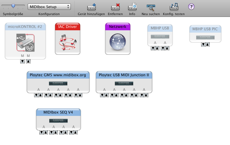

TK. Posted November 21, 2009 Author Report Share Posted November 21, 2009 So I updated to Tiger 10.4.11 yesterday and still no luck. My iBook G4 still doesn't see the USB MIDI. Is there any additional install or something that I must do? MB-SEQ V4 shows on the USB tab on System Profiler and mounting the SD Card goes fine too. But no USB MIDI recognized by any application... everything is just as it was with Panther. No, an additional installation isn't required. Do you see the device in the Audio-MIDI Setup Application? (see Attachment) Best Regards, Thorsten. Quote Link to comment Share on other sites More sharing options...
vcfool Posted November 21, 2009 Report Share Posted November 21, 2009 No, an additional installation isn't required. Do you see the device in the Audio-MIDI Setup Application? (see Attachment) Best Regards, Thorsten. Nope. There's only my MOTU FastLane (and IAC driver, and Network), as usual. Already tried Rescan several times before. Quote Link to comment Share on other sites More sharing options...
TK. Posted November 21, 2009 Author Report Share Posted November 21, 2009 Then I've no idea. Maybe google helps you to find more informations about using a Standard USB MIDI device on a PowerPC based Mac. Best Regards, Thorsten. P.S.: it could be important that your core module is powered from an external PSU, or from an USB hub with a "strong" PSU supply. Quote Link to comment Share on other sites More sharing options...
vcfool Posted November 22, 2009 Report Share Posted November 22, 2009 Then I've no idea. Maybe google helps you to find more informations about using a Standard USB MIDI device on a PowerPC based Mac. Best Regards, Thorsten. P.S.: it could be important that your core module is powered from an external PSU, or from a USB hub with a "strong" PSU supply. Thanks a lot. I've googled a little and didn't found much, I will post here if I find a solution. The Core is powered from it's own external PSU. The USB MIDI has been working on a Windows PC since day 1. I've uploaded the .hex files from there through USB. I never got MIOS Studio to work under Panther, so it's been good to update to Tiger, because now it works great... at least with "normal" MIDI through the FastLane. :) Anyway I just wanted to know if there was some step I may have missed, I don't wanna turn this topic into "troubleshooting my USB", so... ...back to the suggestions: Multi Triggers have been replaced by the Roll function which can be assigned to an individual layer. Advantage: now multi triggers also change their velocity. Another advantage: higher granularity for Length parameter (1..96 ticks) As the beyond-the-glide mode is still in the V4 Manual I thought it was still working. I didn't knew that Length had some effect in Roll. I have been trying. In V3 you could define the ticks in between repeats quite nicely. For what I undestand, now you do it with the Length, but it only seems to work when 4 or 5 Repeats in Roll are selected. When 2 or 3 it always does the same. How can you do it in Drum Tracks when no Length Layer is there? And... some more thoughts: -In a Note Parameter Layer, and maybe also in a Chord Layer, activating "FAST" could switch the encoders to octave jumps. I'd find that really useful. What do you people think? -In Drum Mode Trigger Layers. Maybe removing a Gate could also remove the ACCent. And inserting an ACCent could also insert a Gate. -Wouldn't it be nice to apply Grooves to the DIN SYNC clock output? ;) Thanks again! Quote Link to comment Share on other sites More sharing options...
